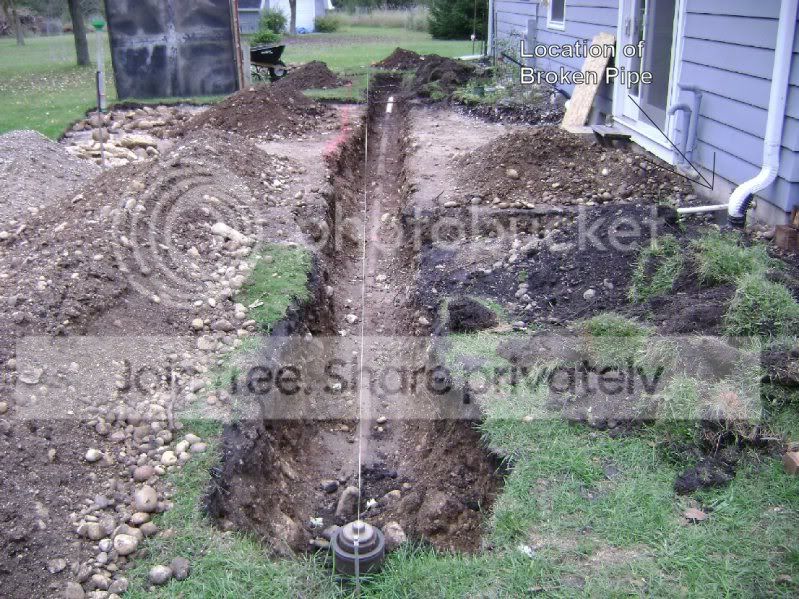

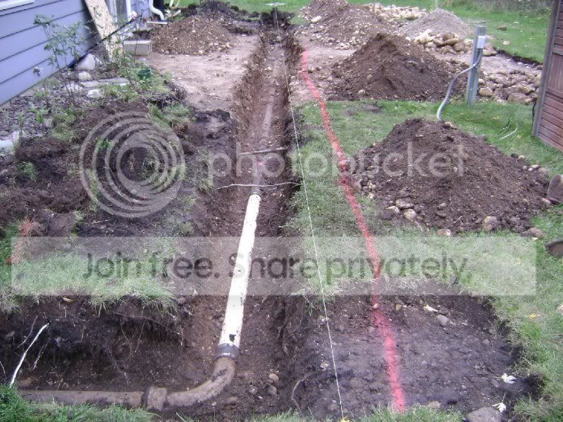

I've completed exposing the line, and this is what I've found:
- It is composed of 5 ft sections of XH cast hub connected w/ rubber inserts.
- It is completely broken off just outside the foundation where it leaves the house closest to the septic tank (see pic). The allignment is still intact, but it has separated about 1/8".
- The far end of the line is not square to the building.
- The PVC portion is a patch job from 10 years ago when a backhoe struck the line while replacing the electrical service.
Is it safe to assume that the break is due to the out of whack allignment?
As shown in the picture, I ran a string line that is parallel to the house. I'm guessing my life will be a lot easier if I correct this problem during replacement? Any tips or comments would be greatly appreciated.
The parallel run is about 50 ft, and 9 ft from the house.

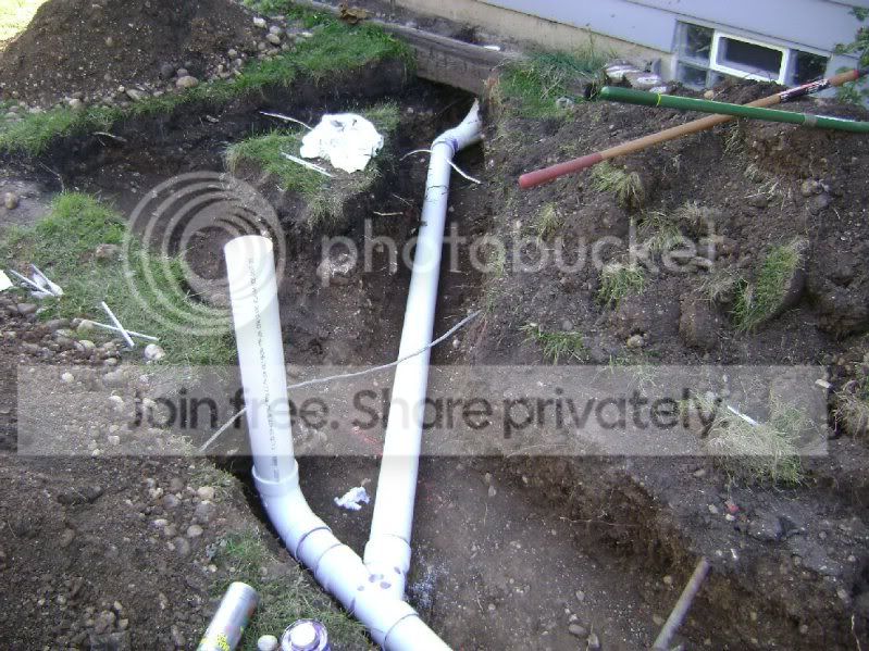

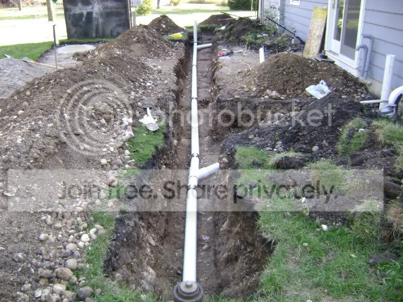

Finally got it changed out today, and it went pretty well. As HJ suggested, I changed all the 90's to 45's. I used shielded fernco couplings and added 3 cleanouts. As you can see from my pic, I had my own "funky" allignment issue at the 2nd wye, but everything went together alright. It wouldn't be a DIY job without a few screwups. LOL
Smunderdog
29
Indiana
For those of us playing along at home...is there a reason you used Fernco couplers to join the straight runs of pipe? Is there a benefit to using those instead of couplers you would glue?
Smith333
136
Wisconsin
There's other threads from a while back that discuss how solvent weld joints underground can break over time if the ground shifts. I'm not sure how likely such an event is, but I tried to avoid solvent weld joints where possible.

I decided to put the cleanout at the far end instead of the middle, which would have been under the deck. This way it will always be accessible. There's also another cleanout right next to the foundation.
