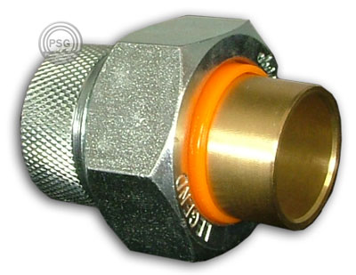

It looks like it transitions from galvanized steel at the tank to brass/bronze to copper, but the steel nipples on tanks are usually dielectric junctions (plastic lined) to prevent galvanic corrosion. On the cold connection appears to be a bit of blue/green copper oxides weeping out through the off-white pipe-dope on the exposed threads of the steel, which may indicates that the dielectric junction may be flawed, but it not necessarily. If you wanted to be sure you could break the connections there and install dielectric-junction unions on both the cold and hot sides, even though the corrosion seems more obvious on the cold side:

The blue green stuff has always been there. I assumed it was some sort of threading to ensure a good seal.
