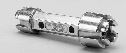

  2. when screwing the drain flange back into the drain shoe is it best to be in the tub, not in the tub, or doesn't matter.
  3. should i have drain shoe (where the slip joint washer is) loosely or tightly coupled near the trap (or maybe not even coupled) before screwing in the drain flange?
  4. when screwing in the flange do i have to worry about the drain shoe rotating as i tighten the flange (i.e should someone be holding the shoe so that it can not rotate).

1. Use foam gasket at the overflow, not at the shoe.
2. I don't think it matters, if the tub is sitting securely. I do it when I'm outside the tub.
3. Ditto to what Terry said.
4. It's better to have a helper holding the drain from under the tub. Too many rotations will damage the rubber flange.
