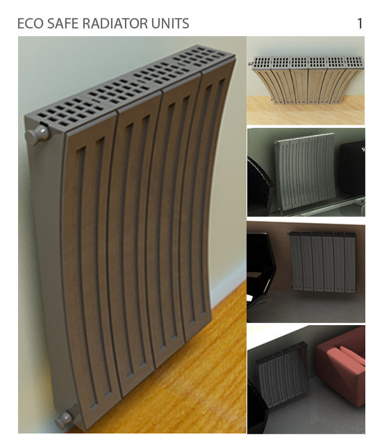

    But there are also things like heated towel-rack radiators, or designer radiators for the tres-chic designer types that'll set you back a heluva lot more per BTU delivered:
    [​IMG]
    [​IMG]
    [​IMG]
    So, there are alot of options- the thin steel panel radiators are probably the least expensive unless you're dropping all the way down to fin-tube baseboard. Cast baseboard is going to run you $40-60/foot, which adds up. (Those can be had used as well, for a half price or less.) Euro-modern & designer panel radiators and towel racks turn into real money real fast too. I personally like to go with recycled Burnham Sunrad or Radiant or similar 5" deep cast iron in classy older houses (they can be sandblasted & repainted quite easily with auto-body type paints- no need for high-temp paints since you're not running steam here), but the sizes you need might not always be readily available on the local used-market. (But they are from the Burnham distributor for only half a leg and one arm. :) ) But you'll know better what YOU want, and where.
