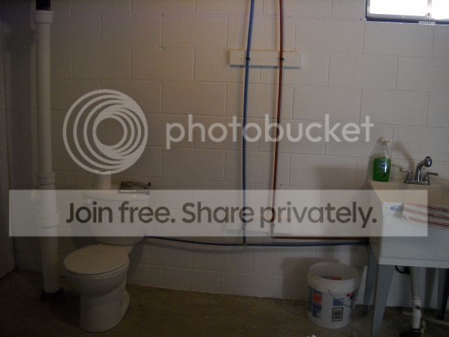

Old post, but gave me a clue to my problem. In my basement I removed a shower stall and put a utility sink in using that drain. It's more than 2 vertical feet from the sink drain to the trap, plus there is no vent on this drain. The drain on this sink is a 2" pipe that runs 6' over and is connected to the closet bend.
Every now and then I go down there and smell a stench. Would flushing that toilet be enough to siphon water out of the trap. Would dumping a gallon bucket of water into that sink be enough to siphon out trap? Also the same vent/drain stack services both upstairs and downstairs toilets. Could the slug of water from upstairs toilet be enough to siphon out the trap on the sink?

A long trapway has enough height that it can siphon a trap. Using a shower drain for a lav doesn't work.
Any plumbing between floors needs to be separated by venting.
Was the home plumbing inspected at the time of installation?

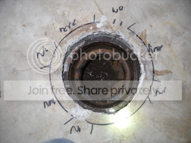

Home was built in 1972. When I bought it 4 years ago the homeowner had a cheap shower stall set up. The closet elbow was actually mostly covered by the concrete floor. I thought it was a hole in concrete and was going to cement over it, and then realized it was a closet elbow that was attatched to the 4" cast iron soil stack. Picture is of it after I chipped away concrete
Here's the finished product.
I just came off my copper with pex, replaced shower with sink and put toilet in so I never had it inspected. I knew the sink should be vented, but the previous owners had been using the shower for years so I firgured I could get away with it. Didn't realize Trap couldn't be a mile from top of drain. dope. Drain from sink just runs parallel to wall over to the closet elbow.

You might get by by adding an AAV (sometimes called a Studor valve) on the sink. Not the best solution, but it might work. They aren't allowed everywhere - a 'real' vent is much preferred. I'm assuming that the drain line in by the toilet is coming from upstairs, and is not a vent (yet, maybe higher up - the pipe can't be both a vent and a drain, except in special situations, and then, only on one floor). If that line IS a vent, then you could tap into it for the sink.

The Pipe next to the toilet is the drain for the upstairs bathroom, and goes right up through the roof. I figured the toilet installation was ok because the drain pipe was a "wet" vent.
Since the install there is never an all time stench coming from this room. Just once in a while you have a weird sewer gas type of smell. I usually just run some water in sink and next time I come back the smell is gone.

If your local codes allow it, the simplest fix would be an AAV. Properly installed, that should stop the siphoning of the sink trap.

You need your trap arm from the sink to run to the (proper) T, with a stub going up for the AAV, and down to the drain. IOW, the same configuration as if it were going up to a standard vent.

Without major "surgery" I can't fix this installation. I thought about the AAV, but no matter where I but that it's going to be above the trap...which is in the floor. I disconnected undersink drain from the pipe comeing out of floor and the underslab trap stays full after dumping a bunch of water down it and flushing toilets. The water in both the downstairs toilet and underslab trap does move up and down when toilets are flushed, but it doesn't siphon water out of it instantly.
I guess it's been this way for 2-3 years, so I'll just have to deal with it.
