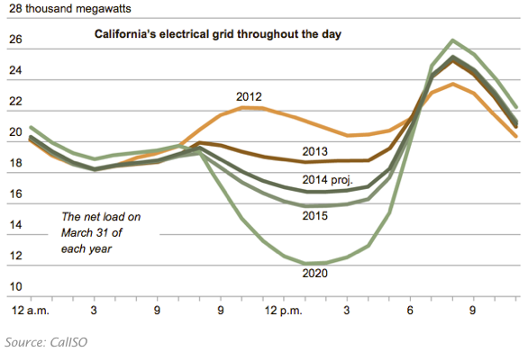

The peak grid load in the CA-ISO grid is typically ~8PM, and NOT during the air-conditioning peak load. That is an artifact of people leaving the AC off during the day, then coming home, cranking on the AC while they head for the showers (turning on the hot water heater) , cooking meals, & settling down to eat while spinning up a Bollywood chick-flick on the big-screen TV, etc. A good thing for reducing grid infrastructure costs would be to pre-cool the house during the day then turning off the AC between 6-10PM, since that would reduce the absolute peak grid load.
As more solar power goes onto the CA grid the evening peak load creates a ramping problem for the generators and grid operators, since the solar output is fading just as the evening load is starting to pick up. If/when rates get restructured to promote different use patterns it may become financially advantageous to pre-cool as a matter of course. The ramp problem is more exaggerated in the early spring when mid-day loading from AC is even lower:
If you're billed at flat rate based on just energy usage it doesn't make pure financial sense to pre-cool, but you'd be more comfortable if you did.
