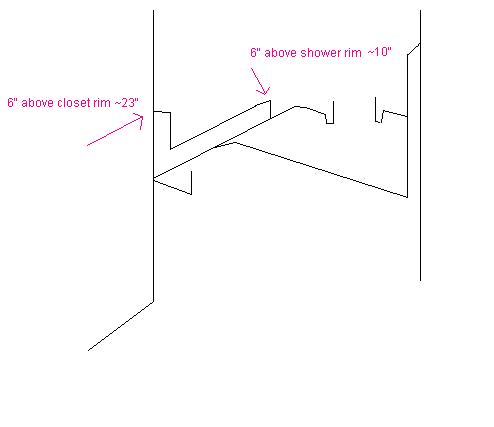

I'm planning to add a 2nd floor bathroom and I'm wondering if this plan is acceptable for the DWV system. If so, can it be simplified in any way?
Thank you

That's pretty good.
The toilet is the only fixture that doesn't need a trap, it's in the bowl itself. You would just 90 up to a closet flange.
I like that you revented at the lav, into the downstairs vent at 42"
I see a vent for the shower, good, you could also use 1.5" for the shower vent, and keep the 2" for the trap and waste. It is fine if you oversize the vent though too.

A few more questions...
1) Does it matter if the shower drain enters the main stack above or below the toilet drain?
2) Does the shower vent horizontal run have to be 42" above the floor or just 6" above the trap wier?
3) I'm in Minnesota. Can the horizontal shower vent run on the cold side of an exterior wall. (It's a knee wall). I was planning to attach it to the back of the studs.
Thanks

nelsonba said:
.... 1) ... shower drain ...above or below the toilet drain?
doesn't matter.

Weir of the trap has no bearing on horizontal venting height, only on distance of trap to vent, offsets before vent and tailpiece length. But on to what you meant.
MN Plumbing Code: http://www.revisor.leg.state.mn.us/bin/getpub.php?pubtype=RULE_CHAP&year=current&chapter=4715
4715.2540 VENT GRADES AND CONNECTIONS.
Subpart 1. Vent grade. All vent and branch vent pipes
shall be so graded and connected as to drain back to a soil or
waste pipe by gravity.

While it is legal to run the shower vent horizontally 6" above the spill line of the shower, your connection into the 3" vent stack must accomodate the same requirement of the water closet (as the 3" is it's vent).
Theoretically, it could be piped like this:
attachment.php
But, if one really wanted to be a devil's advocate, it could be argued that if all of the following occurred at once,
1: 3" stack below water closet plugged
2: water closet trapway plugged
3: shower trap plugged
water from the lavatory and toilet could compromise the horizontal potions of the shower vent, bringing with it paper and maybe some floaters (lol) that could stay after the stoppages were taken care of.
Now that is an extreme example that could probably only happen as a result of a fraternity prank, but it is possible. Just think if there was a waterproof partition that extended upwards from the lavatory! :eek:
Thats why we just pipe the stuff at 42", too much thinking otherwise.
