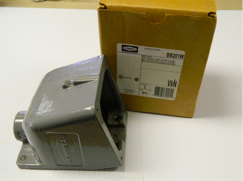

How exactly are these boxes generally mounted ?
I've yet to order the box....but wanted some info.

I see top mounting holes and holes on the inside on the bottom. Surely, I don't think one is to mount the screw from inside the box to a wall ?
What do you think would be wrong with the mounting nole being on the inside. We mount many enclosures with screws on the inside such as but not limited to meter base, panel. four square boxes, ect.......

Yes, but the holes for those is a straight shot....unless they expect use to use a right angle driver to drive the screw in...
Yes, it's for a portable generator.
I wanted something fairly weather resistent - in use.
I originally used a regular connector and ordered the Midwest inlet
I received the inlet, and it was a beast in size.
So I switched systems and went with the Hubbell Safety Shroud system and the box posted in the original post is the box I plan to use.
