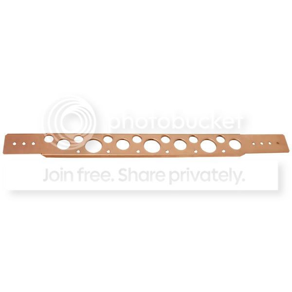

    what is the best method to stub out a pex supply line?
    i was planning on using some of these pex to copper ells
    [​IMG]
    but I was wondering what the best way to secure them is? should i run some blocking behind them and strap to it and then put one of those copper plates with all the holes in front of it?
    i have also seen some of those ells with a nailing plate on them, is that a better solution?
    Terry, you seem to always have the perfect picture for these things. Do you have an example of a pretty PEX stubout?
    Thanks.
    Rob

    Probably the ideal way is to use a copper stub bracket and solder the stubouts to it.

    Should I also strap the ell to some blocking or will the bracket be enough?
    Thanks
  7. jadnashua
    Joined:
    Sep 2, 2004
    Occupation:
    Location:
    You may have missed the suggested step...solder the el to the bracket. That should be plenty to hold it in place.
