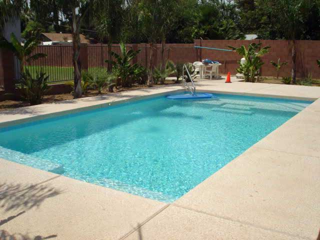

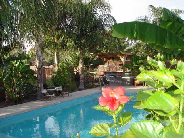

Here's my pool. It's about 5 years old and the landscape is starting to really take shape.
