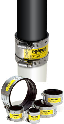

    So I spoke with a local guy I know who was a plumber for years, now he works in IT/Telecom installation.
    He actually did the leak oakum joints and everything.. he is in his 60's now.
    He recommended going with the fernco couple and doing a leak test.
    Since I have to break more concrete and go further down, I am thinking about cutting the drain before the trap, going to PVC, extending it horizontally to the right, this way I can fit a 48" shower pan on center, instead of the smaller 42".
    Do you guys see anything wrong with doing it this way? The fernco site says these coupler/adapters can be buried in concrete.
    Any comments/suggestions? Thanks!

    I'll have to post some pics, but I ended up jackhammering the floor, cutting out the old cast iron trap, and using a rigid fernco coupler to attach the new pvc trap and drain. The floor is poured back now, and the new fiberglass shower pan is set.
