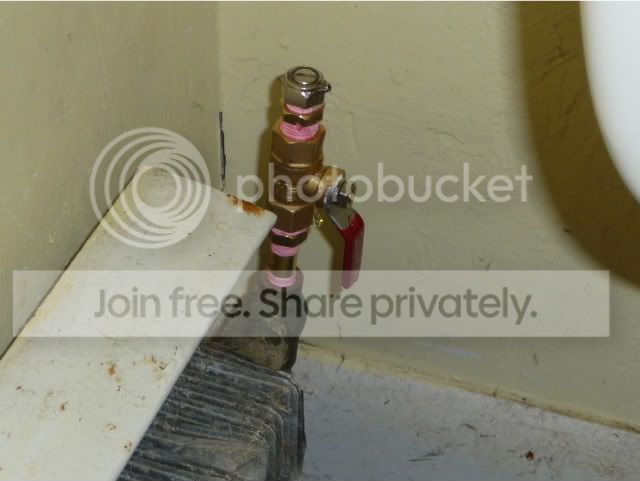

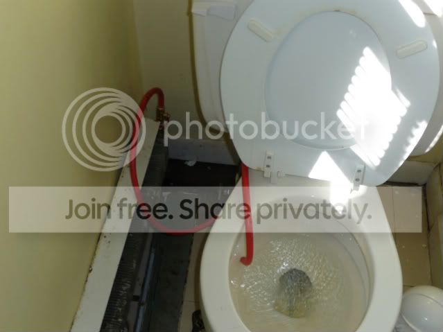

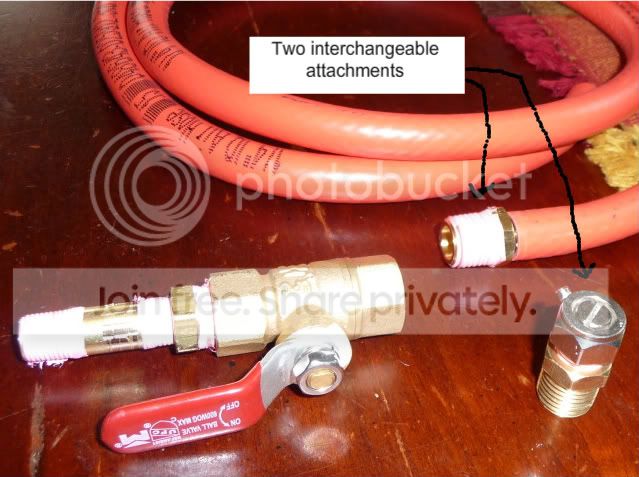

    All of my baseboards are now heating so I wanted to close the loop on this in case others are having a similar problem.
    For 2 of the three non working units, the air must have been trapped in the return pipe (the return pipe does a 180 after the bleed valve and travels back underneath the finned part and goes down through the floor a few inches from where the supply pipe comes up). By bleeding the baseboard with the supply valve closed, I was able to force the air out of the return pipe and get those two units working.
    The third unit, which was in the bathroom, was more stubborn. I would bleed it until I got hot water out of the bleed valve. This took about 6 cups of bleeding. Then I would close the supply valve and bleed the return pipe until I got hot water again, about another 4-6 cups. At this point, the pipes were hot from supply to return. After this, however, the baseboard would just cool down and not get hot again.
    I finally forced the trapped air out by making a higher capacity bleeder. I then turned the boiler off and pumped up the expansion tank to about 25 psi and bled the baseboard, After a couple of seconds of pretty strong flow, I got the air out and it has been working fine since.
    Below are some pictures of the high capacity bleeder before and during use.
    Thanks all for your help.
