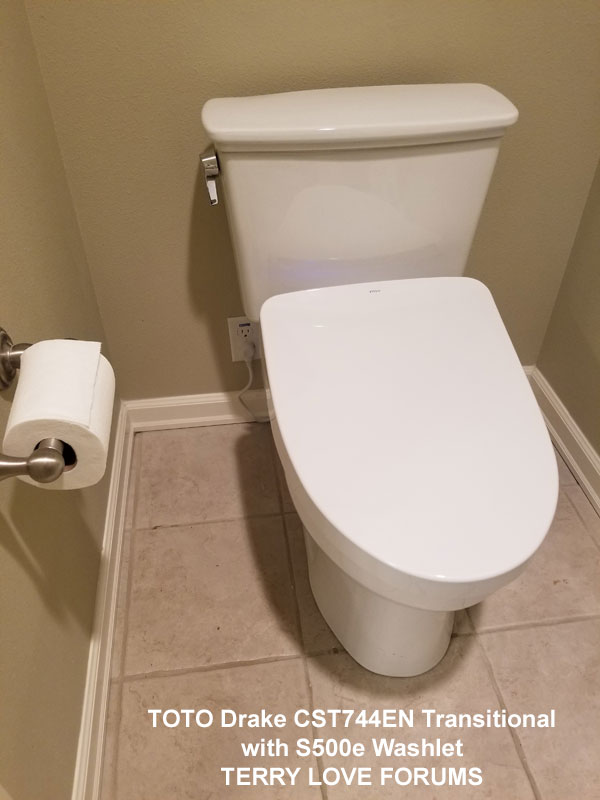

A hard-to-get-used-to new tank for the original Drake 1.28 version.
Upon further review, it appears that Drakes with this new tank are available to be ordered, if not heavily in stock at many places. The MSRP is about $30 more than the unit with the old tank. The new model numbers are the same as the old model numbers, with the exception of an "N" added to the model. So, whereas the elongated original Drake with the old tank is CST744E in the 1.28, the elongated original Drake with the new tank will be CST744EN. And so on. They are also making a version of the new tank with a right-hand trip lever, but it's unclear whether they will be making the bolt-down lid, insulated tank, etc. SPEC SHEET FOR CST744EN Whereas the tank was model number ST743 for both the CST744E (elongated) and CST743E (round) -- i.e. there was no ST744E tank -- the new tank has been given model number ST744E for use on both the round and the elongated bowls.
One other oddity about the new tank is that the spec sheet now claims that the space between tank and wall on the Round Drake is between 5/16" and 1" and on the Elongated Drake is between 1/2" and 1-1/8". That's a huge variance, well beyond any kiln-error numbers. As you know, the CST743E tank regularly left 1" to 1-1/8" between tank and wall, allowing this toilet to be squeezed in on irregular rough-ins. I don't know what the point of that spec is, except perhaps to suggest that if you back the most-protruding portion of the base against the wall, there will be 5/16" behind the tank, and otherwise a full inch? It's really quite unclear.

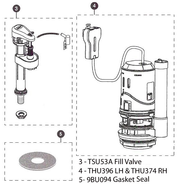

Cool. The only danger is that the 1G system, as installed in the Drake II, replaces the simple flapper flush valve and standard trip lever. Instead, they have a gear-thingy on the trip lever that's connected to a wrapped wire that's attached to a flush-tower assembly. This apparently is to more-precisely-control the flush. It may be that the hole in the porcelain is the standard size that's used in the Drake II (although the 1G tank itself is a different shape from the standard Drake II), and thus you MIGHT be able to use the Korky 3" flush valve replacement kit and a new standard trip lever on it if you hated it, but I'm not sure. It's just less of a backup plan than one currently has available with the 1.28 system, which can be easily converted to flow a little more water per flush if necessary. We haven't found the need to do so, so I guess this is conjecture, but it makes the decision a no-brainer if there's a way to reverse it if it sucks. That said, as I say, the reviews have all been very positive, including one that I think someone posted on here with pictures. Okay, found it -- start looking at post #12 for photos and some comments by a guy who bought and installed one (you can see the interior guts in his photos): https://terrylove.com/forums/showth...is-up-on-the-Toto-Web-Site&highlight=drake+II

The Connelly is available, but doesn't seem to be in wide distribution. It has the dual-flush, and thus a more complicated flush valve; not just a flapper.
