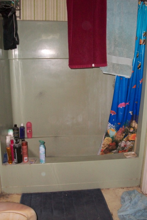

    I've mentioned this before when I first came to this forum. This avocado green thing is hideous and the bottom cracked under my brother's weight.
    I'm all thumbs with measuring tapes but it seems like the outside measurements were about 59.5" or so (I couldn't get an accurate measurement because I don't know the trick to get the end to hold still (I couldn't find a thicker measuring tape so the one I had was flimsy).
    The height of the tub wall on the front comes up to about 13.5". The height of the shower walls are close to 6'. From the wall to the front was about 31.5". I'm probably doing all of the measurement listings out of order.
    This is the best shot I could get of the shower (the shower head and drain are on the right behind the curtain).

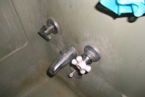

    Here is the tub faucet (yes, I know the way it is sticking out and not sealed is very bad-- the whole assembly moves inside the wall).

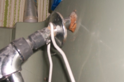

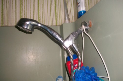

    Here is the shower head (the reddish brown color is from the water-- we haven't installed the water softener yet; the hot water is particularly nasty).

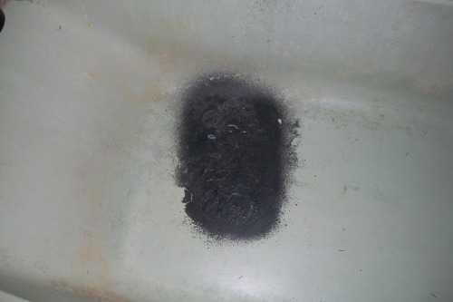

    Here is the spot on the tub floor that cracked and my brother attempted to fix it with Flex Seal. You can see that it splattered on the wall.

    Generally, you want to stay with one manufacturer when you want a surround that will mate up with a particular tub for a surround. With any tub, especially fiberglass, steel, and acrylic, you need the thing properly bedded into something solid (stuctolite, mortar, gypsum can all be used) so that there is no flex in the bottom and they are set perfectly level. If that is done, the weight of the person using it is mostly irrelevant. Otherwise, the bottom will flex, and stress cracks are likely to form with eventually the thing cracking (often at the drain). What you have is a standard 60" tub. They are measured from stud-to-stud, not between the finished walls. Now, some of them are slightly less than that, and may need shims if the space was made at 60". Sorry, I don't have enough experience with various brands to make a recommendation. You will need to read the specifications carefully to determine how and if a safety grab bar(s) can be added. Most of them that have a bar in there are NOT rated as a safety grab bar, but it is intended to be used as a rod for a washcloth, or maybe a towel. To put a safety grab bar on, you'd need to first determine where you wanted one, install some solid blocking in the walls and probably add more so it was sticking out beyond the studs to account for the fairly common bowing of the surround (most only meet the studs at the top and bottom, and bow out from there - the blocking would need to be right beneath the wall so when you screwed it on, it didn't bend the wall back to the studs). As to the toilet floor, it sounds like the toilet was leaking for a long time, which rotted the floor. When you set a toilet, if it rocks, it must be shimmed rock solid, or that rocking will mush the wax seal and leave gaps.
