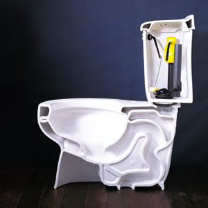

Why would a 5 gal toilet plug up more often than a 1.28 gallon toilet? The pressure from 5 gallons must be stronger than using far less water.
38,858
4,428
The way that I picture it, the 1.28 gets a lot more speed on its water. The flush is sudden and short. There is a big siphon jet to get the water going to the trap the right way. The trap is less angled and more smooth with less turbulence so there is less to get caught up on. The higher exit speed gives it momentum.
The older toilet may have a small or no siphon jet. The water rises in the bowl and swirls more lazily before exiting.
Another bonus of the lower water use toilets is that if there were an unlikely plug, a flush does not have enough water to overflow the bowl.
Here is a drawing of some older toilet cross sections. Note they have sharp switch-backs in their traps. The siphon jet drawing is a really small path.
Compare that with the smoother turns of a newer toilet:
The old five gallon toilets needed a plunger by them. I grew up with five gallons, and plunging was the order of the day.
With the new bowls, most people would use a plunger so rarely, that "finding" the plunger is a problem.
In my mothers home, three bathrooms and old toilets replaced with the new low water usage toilets and constantly 30-40 people on weekends, we went several years without needing a plunger. That's how good the new stuff is.
