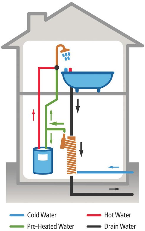

    Yes, adding more sprays depletes the tank faster.
    At 68psi you'd still be getting "pretty good" gallons per minute (gpm) through half-inch, but if it's a long run it could become the limiting factor. Add up the rated gpm numbers for the heads (including the main head), and tell us the length of run (including the number of ells) between the water heater and the shower.
    Short of installing a newer bigger tank with more storage volume/burner, for about $500-600 in hardware you could install a drainwater heat recovery heat exchanger, feeding both the water heater's & shower's cold inputs, effectively doubling the "apparent volume" of the water heater while cutting the fuel use in half. NRCan lists 3rd-party tested efficiency at a standard 2.5gpm flow rate, but note that at higher flow rates you'll get somewhat lower net recovery efficiency, but even at 6 gpm a unit that tests at 50% @ 2.5gpm would be delivering about 40%, with a very significant boost in apparent capacity. In general, within a product line the longer & fatter the heat exchanger, the higher the efficiency. It needs to be installed vertically, so it's not going to be a solution for first floor showers on slab-on-grade houses.

    I see that hot water supply is a big concern. Can the heat exchanger be installed "locally"? By locally I mean in the subfloor near the drain or in the wall near the body spray? If I have to tear down more of the house, it won't be an option. I would then prefer to use a tankless water heater.
    How expensive is such heat exchanger?

    The waste water heat exchanger works far better if it can be installed vertically...essentially, the drain water from the shower must drop down through it, so it must be under the shower, or somewhere where that drops vertically in the wall before it drains out to the sewer. Then, the cold water supply runs through the heat exchanger on the clean (potable) side to pick up heat as the water drains, preheating the water and lessening the load on the WH and the amount of full hot needed. When water drains through a vertical pipe, it tends to fall in sheets in contact with the inside wall of the drain, which maximizes the surface area of the heat exchanger. Horizontal heat exchangers are not anywhere near as efficient, since gravity would almost always leave most of the pipe surface uncovered by the flowing waste water. So, unless you have a vertical drop somewhere where you could insert one, it isn't in your future. A few more things to keep in mind, because the incoming water to a WH is cold, and it mixes with what's already in the tank, you will never be able to use the entire volume of the tank that started at a fixed temp...it will start to cool off near the end. You should only count on getting in the order of 70-75% of the volume of any WH before it starts to cool off. RE tankless, in Gilroy, it's possible that your winter, incoming water temps could end up quite low. A tankless system's output decreases significantly as the incoming water temp drops. The big numbers on their advertising are for typical, national summer water temps. Expect maybe a 70-degree rise at the stated flow rate. If your water temp can get to near freezing like it can where I live in the winter, that's 100-degrees at best unless the flow rate drops. You need to read the fine print carefully...it might work fine in the summer, but not in the winter. The joy of endless hot water can be a very expensive operation, and very frustrating unless you understand and plan for your actual needs under real conditions.

    If you buy through EFI (link found on my first post) you can get a decent ~53% efficiency 4" x 48" for about $600, (delivered), which is far cheaper than any manufacturer's buy-direct or the Home Depot online price at any similar performance point. (You can open an account with EFI over the phone with a credit card to get their listed price, or at least that was my experience a few years ago. I've bought other goods from them since- they're a decent vendor, good communication, no markup on shipping, always very professional.)
    They need to be mounted vertically for soapy drainwater to have sufficient surface tension to spread out for good heat transfer. Anywhere downstream of the shower's drain flow is fine, as long as it's dead-straight vertical. They also need to feed both the cold-side of the hot water heater AND the cold side of the shower to deliver the rated performance. It's usually easiest to plumb it in next to the water heater, but it'll still work from 50' away, if need be.
