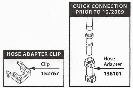

    Hi all, The story, Last week I installed a Moen Kitchen faucet with side sprayer hydrolock connection. It leaked from the top of the hydrolock connector where it meets the supply tube from the faucet. Took the connection apart several times but no luck.
    Finally had enough and took the faucet back for an exchange. It does the same thing.
    The connector merely pushs on and you push the locking clip. Is it possible to mess up something this simple or am I getting bad faucets? Thanks, Frank

    Can you post a pic of where it is leaking so that we could try and determine if the locks have been damaged in any way, or whether they may be defective?
    I've never had a problem like that, but I would be interested In finding the cause

    Here's a pic. Leaks out the very top of the lock where it meets the brass tube and then runs down the connector and hose.
    Doen't leak constantly. Usally about five minutes after washing dishes it will drip maybe a teaspoonor so of water.

    Sorry about the leaks you are having....and not that it is related to your leak, but the teflon tape we see in two places in the photo is SO wrong!

    Looking at that picture I would think that the connector is not pushed all the way up. They usually push-on and then you have to give it a little extra push to get it to sit properly.

    Same problem as noted above after 2 years of use as a new install/kitchen remodel. Replaced the two O rings on the "male" part of the Hydrolock system. Is there another set of O rings internal in the plastic Hydrolock connector as well ? Also, Hydrolock is only about 3/4 to 1 inch overall length - no where as long as unit shown in photos above.
    Anyone have same problem - and how was it fixed - short of returning faucet assembly for a different brand or model?
