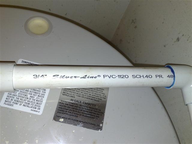

thank you for the pictures
Bored again this morning
thank you for the pictures.....
1. the junction box is about normal that is no big deal
2. the water lines look pretty crappy and they should have been changed out to new flex connectors.... that will come back and screw you eventually......they cost about only 10 bucks each to clean that up
3. I guess the chimmney is no big deal, but it looks crappy just hanging there....it does keep the water heater cool with ventilation, I guess....??
4. The PVC issue is basiacally a joke .... it will work ok for probably 100 years... but the cpvc is what you are supposed to use if it gets inspected....
where does it release down to... just down to the floor or into the crawl space???
5 the waterheater should have been installed in a pan with the pop off pipe dropping down into it... then the pan should have been piped into the crawl space if you have one... you can clearly see where the old heater already damaged the tile on the floor..
as far as the water heater exploding, it aint gonna happen too often..
that job is worse than I have seen the lowes guys and home depot do work for... I quote it at no more than $250.00.....

yes it is
Redwood, it should be cpvc and that is what I use all the time....
but you know as well as me that the pvc sch40 will work for a hundred years.....how many potable water systems have you seen jack-legged in pvc sch40 both on hot and cold in your carreer????
we both know it is wrong in theory....and the odds are
their will never,,, ever be a problem with it.
being a non pressure drain line for the heater is not
too criticle...
I suppose if steam literally came out of the heater
it could eventually warp the pipe , but I doubt it would melt it......
but just to be a pain in the ass,
I would make him change it:cool::cool:.

I guess you are right Mark...
It will do fine until the day it is actually needed....
Then it will just look like those pvc drain lines someone puts in a commercial kitchen for a dishwasher drain...

will work till it fails....
the restraunt pvc pipe is a great example of what steaming hot water does to pvc pipe...
that is probably about right,,, the pipe might warp from intence heat or steam...but it wont actually melt away......
I feel as long as it dont go down into the crawl space it would work fine...
we did have one that was piped into someones crawl space that caused massive damage one time...
the releif valve popped off and kept popping off for about a month or two...
the people were too stupid to figure out what was going on and eventually the steam in the crawl space warped the plywood floors throughout the center of the home....
you could write your name in the humidity on all their windows.
the insurance company was not amused:cool:....

We wouldn't be allowed to run PVC for a relief line. And we couldn't trap it either. It is the permits and the inspections that prevent a lot of this. But do we come across bad stuff? Sometimes. Like the heater that flew 400 feet through air in the Seattle area that did make the news, someone had plugged a leaking T&P.

Terry what do you use for relief lines, I just checked and mine is PVC too... :(
29,946
3,460
I've been using copper.
I don't have any PVC fittings in the truck.
I don't work outside the foundation very often. UPC code doesn't allow PVC inside the foundation, and only for cold water.
Some of the newer homes, I've seen CPVC being used. I haven't done new construction for a while.
