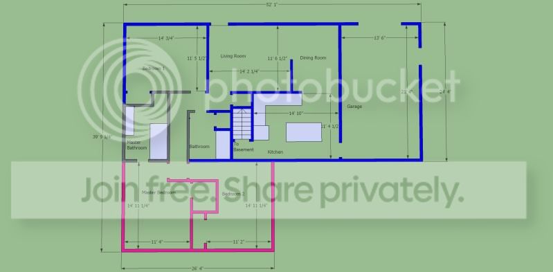

    First off-great forum! Glad I found this place! My wife and I bought our 700 SF single story 2 bedroom/1 bathroom ranch with attached garage in Northwestern NJ a little over three years ago. We just finished the basement which gave us an extra 400 SF of living space in the form of a family room, but we'll need more room soon. We knew we would either have to add on or move one day since we are hoping to have three children (our first is due this September :eek:) eventually, so with the housing market being what it is, I think it would be wise to plan for an addition in the next 4-5 years. Basically we need one more full bath and one more bedroom for a total of three bedrooms and two full baths. The addition I've sketched out will simply be a 15' x 26' box tacked onto the rear of our existing home. This will provide the space for two new bedrooms. One of the existing bedrooms will be divided into space for a hallway to access the two new bedrooms, and a full bath connected to the master bedroom. I've been fooling around with ideas in Google Sketchup (amazing tool considering it's a free download) and made up a graphic to illustrate the existing house vs. the planned addition:
    [​IMG]
    The blue walls are the existing walls of the home so you can pretty much tell what the original building envelope looks like. The pink walls represent the planned new construction. The grey walls represent the present bedroom which will be cut up into a hallway and a master bathroom. I realize this isn't a DIY construction site, but I figured that some background would be helpful. Right now the home has a 6 year old forced air oil furnace which we supplement with an add-on wood furnace which is integrated into the existing ductwork. We like heating with wood, and provide most of our heat this way, burning five cords or so per winter, but we hate the forced air heat. There are lots of cold spots in the house no matter what we do, and the dryness is just awful in the dead of winter. In any event, we want to be rid of it when we renovate. I will be doing a lot of the work myself-my FIL is in the construction industry and will be serving as my adviser for the entire project. He will get me subs for the excavation, foundation (there will be a full basement under the addition), and electrical, but the rest we'll be doing ourselves/with the help of a few laborers. Basically I'm trying to get an idea of what skills, tools, etc...I need to install an oil boiler myself.

    Even with pex there is still going to be a lot of soldering. All the baseboards need adapters soldered on both ends as well as having to be soldered together to form runs longer than 10' Then there is all of the manifold work on the boiler itself.

    Pex is neat stuff, and works. Soldering isn't really that hard if you follow some strict rules: make the pipe and the socket shiney bright and clean, flux both parts, heat the socket until it will melt solder, and apply solder to the joint, not in the flame, but melted by the heat of the metal. $10 in joints and some pipe and some practice, and you'll be good enough (not great or neat and fast) but leakproof. It also helps if you wipe the hot joint to remove excess solder and make it look better - lots of drips are a sign of sloppy or inexperienced workmanship and it gives you a chance to see how evenly the solder flowed around the joint.
    Once you have your heat load analysis, each baseboard heater will have a spec sheet of how much heat per foot it can produce with a specific water temp input and a specific flow rate. You make the thing long enough at a temp you prefer, and you'll know the heat level it can provide. Different types and brands or models will produce a different amount of heat.
    What you are attempting is something people go to school (apprentice, college, etc.) many years to figure out. It is not for the feint of heart, and expect some glitches (that may be expensive). Trying to get a foolproof plan over the internet is asking a lot, and unlikely to produce optimum results.
