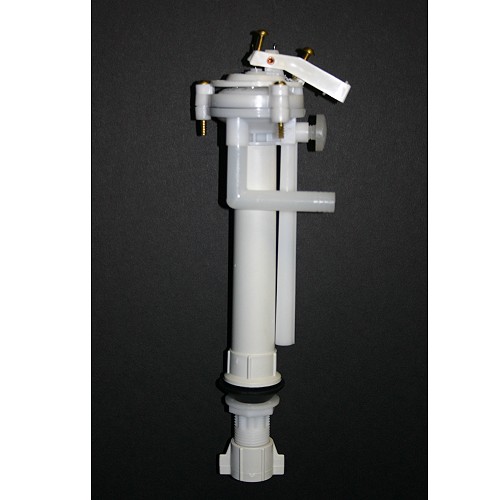

My mom has 3 Kohler toilets, model K-3397 EB. One of them has started running and bubbling continuously. Kohler has told her that the part we need, #84499 (flush valve?), isn't manufactured anymore and she'll have to buy a new toilet. I found an earlier post on this board saying it was possible to repair a Kohler with a rebuild kit. Can you tell us what we need, and if it's available anywhere? Thanks so much. Suzanna Spring

The 84499 is listed as "1B1X conversion kit." Per the parts diagram for the K-3397 this includes the fill valve and the flush valve. You can get replacement San Raphael flappers, and I am pretty sure that you can get a Coast 1B1X ballcock and retrofit that in.
I don't know what the "EB" in your model is, and whether that is a variant that rules out what I mentioned above.
In some cases in the past, when Kohler has discontinued supporting a toilet...unoffically a "recall", they would provide some sort of voucher towards purchase of a new model. Why not ask them about that.

I replace the fill valve with the Coast 1B-1-X and the flapper with a Korky from HD. You cut off the Kohler plastic rim flush pipe and insert the Coast one into it after it is cut to size.

I purchased the Grigg 84499 rebuild kit and after a few days, it began to leak again. The problem was the red -one flapper fits all - that they send with the kit. The round protrusion on the bottom of the flapper is too small and over time, it allows the flapper to offset itself in the drain hole to the point where water starts to leak around the edge of the flapper. To cure this, I just placed a 1/4 " bead of silicon caulk around the edge of the protrusion at the bottom of the flapper. This stopped the flapper from offsetting itself and completely cured the leak. Simple, free, and it works!!!!!!

Those parts are too expensive. A Coast 1B1X fill valve and a Korky flapper will restore it to proper operation, IF they are installed properly.

I bought the Costa 1B1X plastic component at Lowe's for $8.74 plus tax and a Korky flap for little over $5. Believe it or not the whole thing works great, no leaks whatever. I was ready to scrap my old San Raphael, last time I replaced the same components on another one I had the replacement (brass) was over $100 with tax.

Home depot also has an adjustable replacement kit with everything but the flapper that is short enough to fit . I have a 3397 Raphel toilet by Kohler with these parts it and it works like new
