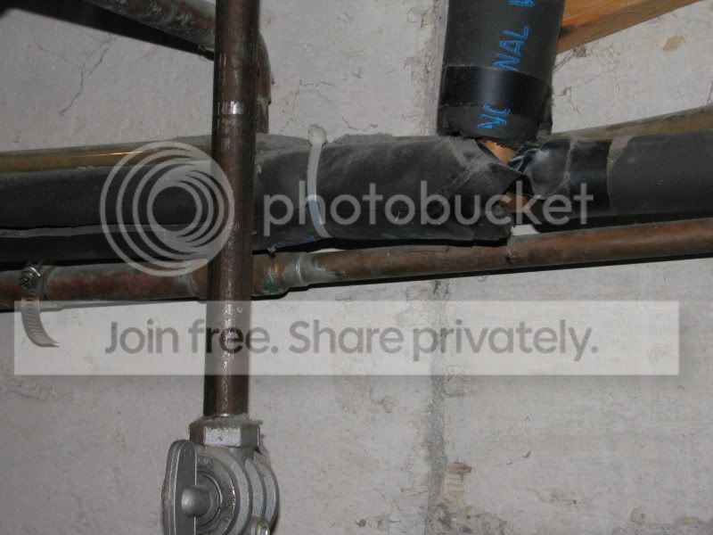

    My water meter is in the garage...when I turn a faucet on the little dial spins and little if no noise...when the washing machine is filling it make s knocking noise that you can hear in each bathroom etc...
    I recently fastened down the copper that went from the water heater to the washing machine as when the washing machine would fill the pipe would visibly shudder........looks like the pipe from water heater is 1/2 inch and where it "T's" with the main water supply it goes down to 1/4 inch to washing machine...any idea why they would have done this?
    [​IMG]
    Pipe from washer back is also on a downward slope as plumber who replaces water heater "pulled" copper pipe down to fit rather put new piece in :mad:
    Does not make noise with other faucets on but does click a little louder when tub is on...I guess the bigger the output (tub washing machine) The louder the clicking?
    Is this an issue?
    Thanks
  2. Gary Swart
    Gary Swart In the Trades
    Joined:
    Sep 1, 2004
    Location:
    Yakima WA
    I don't know what is causing the knocking, but you'd better acquaint yourself with pipe sizes. I think it's most likely that you have 3/4" pipe that is then reduced to 1/2". Even if 1/4" was made in ridged pipe, that would be far too small for a washing machine. !/4" soft copper is often used for ice maker supply lines. One thing you might check is the washer shut off valves. Make sure they are turn completely on. I'm sure some of the pros will give you some better answers, but it may be tomorrow before some of them are online.

  4. shacko
    shacko Master Plumber-Gas Fitter
    Joined:
    Jan 22, 2006
    Occupation:
    Location:
    Rosedale, Md
    I don't know what that picture has to do with the wash machine, show a picture of the wash machine connections. :confused:

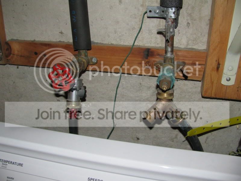

  6. vtxdude
    vtxdude New Member
    Joined:
    Nov 28, 2009
    Location:
    NH
    Sorry, you are right about pipe sizes...I'm learning as I go Gary :eek:
    Her is a pic of the connections...yes I know...not pretty at all...be oblivious for 8 years and now all of a sudden everything is catching up to me I think.....
    [​IMG]
    Why the reduction in pipe size?
    What other info can I provide?
    Thanks

    Washing machines do not have 3/4" connections, thus the reduction to 1/2"
    You sure its not 2 pipes hitting each other ?
