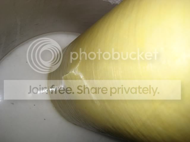

    I've been suffering with a Kenmore softener for 10 or so years. It has only worked for about half the thime I've had it.
    Currently I've let the salt run out so I can clean the Morton pellet residue from the bottom of the salt tank, it has been plugging up the brine valve.
    I just noticed that the outside of the resin tank is delaminating, it looks like the yellowish fiberglass (or whatever it is made of) is cracked.
    Does this affect the operation at all? I don't know how these tanks are constructed.
    If it needs to be replaced, it's time to ditch the whole thing. I need to replace the rotor and seals already, about $100 in parts, if this tank needs to be relpaced too I think it's time for a new softener.

    Yes it has to be replaced before it fails totally and the city or your well pump fills the place with water.
    Put it in by pass, that stops water from going through it. It's a wonder it hasn't burst already.

    There is NO repair for this.. It is time for another system.. thou if you are the first and only owner you might be able to get a tank replacement under warranty.. it is an idea to look into.

    I would describe the damage as a rupture and it is most likely caused by overpressure --perhaps your water supply pressure has increased--or freezing.

    IIRC the warranty on all big box store brand softener media tanks is 3 years. Their electronics used to be 90 days.
    Real softeners have nonprorated 5 years on the tanks and electronics.
