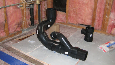

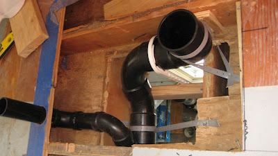

    Here are a couple pictures of the plumbing for my water closet. (One is dry fit and the other shows it installed). Does this look like it's vented this properly? (The vent pipe will extend 4-5' farther up before it turns.)
    [​IMG][​IMG]
    Thanks in advance!

    A vent cannot run horizontally until it is a minimum of 6" above the flood rim of the highest fixture.

    Unfortunately that is a VERY BIG NO. That fails inspeciton for the very real reason that such a horizontal vent would very soon be clogged with waste.

    The last illustration would pass inspection in Chicago, I dont know about your area.The pictures you posted before wouldnt because you had those two fiitings raising the quarter bend above the vent. But like I said this last illustration would pass in Chicago. We often vent suspended toilets, p-traps or showers this way.

    Under the UPC you can run a flat vent the way it's shown, you just have to add a clean-out on the vent where it comes up in the wall.

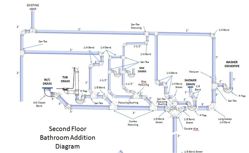

    If the water closet distance is unlimited, can I do something like this. (This is a picture that show more or less how the whole system is designed.)

    Krow, that looks like a clean out there, not a san tee.
