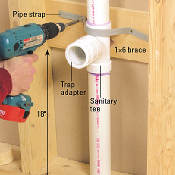

    As much as we dislike the thought of using an air-admittance valve, this would be the place which I would use one.
    To do so, the existing pipe should be coming up out of the floor 17" On top of that install a sani-tee and trap adapter. Off the top of the sani-tee run a straight piece up as high as the vanity will allow and then install the AAV on the top. If you can get the AAV up higher by using a couple of 45's to clear the sink bowl, it would be even better.
    An AAV may or may not be allowed by your plumbing code, but it will work.

    The problem is you must have a trap, and that trap must have a vent. Without either, the sewer gas can come back up the drain and stink up the house.
    Having the pipe in the wall allows a place for the vent pipe to run hidden up through the roof.
    A floating vanity won't be too pretty with a big ugly drain coming up through the floor.

    More trap arm is better, but you're still not venting the drain properly unless you install a santee and at the very least an AAV as high up inside the vanity as possible.
    Personally, I would be opening up the wall, especially if you want to end up with a nice looking floating vanity.

    You would be venting the drain properly if the piping was in the wall.

    You still seem to be confused. Here's some basics. Every fixture must be trapped individually. The trap must be on the same floor as the fixture. Each trap must be vented. A P trap maybe better called a J trap, is directly below the fixture being drained. The water goes into the bottom of the trap, and up the other side. That means at that point, the pipe is sticking straight up. Now it elbows to the wall drain, but before reaching the drain, you must have a vent. As pointed out, a Studor or AAV will work although these are not preferred by most plumbers and not approved under some jurisdictions. These vents are cut into the horizontal live between the P trap and wall with a tee, a pipe extending up toward the bottom of the sink, then a threaded adapter to screw the AAV into. If you do not put a vent in this location, you will create an S trap. I realize the beam is causing a problem, but you will just have to work around that.
