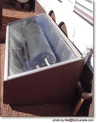

    If the temperatures rarely drop below 0C (an almost never go below -5C) you may be able to use an inexpensive "batch solar heater" as a pre-heat to the boiler. These are fairly simple to build, but there are commercially made versions as well. In much of rural China and rural central/south America batch-solar heaters are often the ONLY hot water heater, and in Israel they are quite common as well.
    http://www.builditsolar.com/Projects/WaterHeating/FSECFS36Batch11349.pdf
    [​IMG]
    Home-built batch heater.
    Many of the commercially made batch heaters utilize evacuated-tube collectors & insulated tanks, and can be installed in colder climates.
    [​IMG]
    Evacuated-tube batch heater
    Batch heaters are very simple and inexpensive- they require no circulation pumps or sensors.

    yea, the batch water tank sounds like a good idea, but in this case the winter air temperature
    can fall to -15º C, or even -20 C, so the water would freeze. Is there a way to get around this problem
    by using a sealed system with a heat exchanger and some kind of anti freeze fluid? Or is that system only
    for a solar panel? Oh, I just remembered - isn't there a system that works as follows? You have say, a 500 liter
    insulated water tank in the garage, BUT it contains only maybe 300 liters of water,the rest is air. Then this tank
    is connected by a pipe to an exterior solar panel or batch heater, which must be at a higher level than the garage tank.
    So, this solar panel or exterior tank contains water ONLY when the circulation pump is turned on. When switched off, the water
    falls to the garage tank and the air rises to fill the exterior tank /solar panel. But I suppose this would only work in a sealed (heat exchanger)
    system? And the more usual in this case is to use an anti-freeze fluid?

    Some of the evacuated-tube versions of batch heaters can work at -20C temperatures. On those the thermal mass and insulation of the tank protect the tank from freezing. The risk is primarily to the pipes going to & from the tank.
    The "drain-back" approach with the pumps works, but it's more expensive and has more maintenance & repair issues to attend to. Flat panels with glycol anti-freeze in the panel loop, with a heat exchanger for the potable water is the most common sort of system in that sort of climate, but it is even more expensive.
