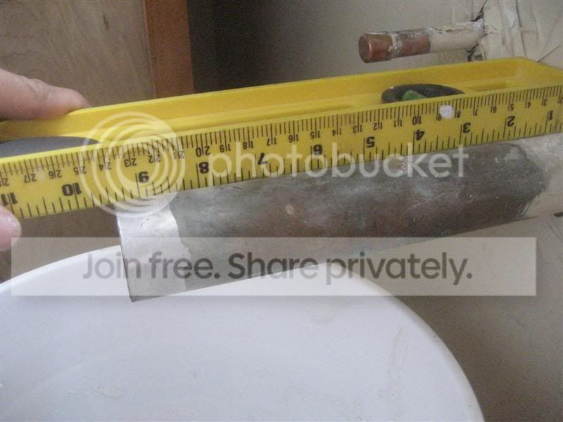

    Hey all,
    Just got my undermount sink in and now I need to hook everything up to the sink (faucet, p trap, etc). This is the first time I will ever do something like this and I'm not that clueless but somewhat lost.
    Should I use the chrome or the plastic piping? I would like a nice look under the sink. I know, I know, nobody really looks under there but I would gather it would look nice. If the plastic is the best and easiest way to do it, I'll go with that.
    Now the drain pipe is coming out 9 inches. WOuld I have to cut this? If putting in the chrome pipe, do I need to solder the connections? Thanks!

    Under a cabinet, I don't think appearance is an issue. Plastic probably has an edge in longevity...as in foever, whereas a brass trap will corrode ...eventually.... A brass, or chrome plated, probably has a higher success rate of not leaking at initial install. Plastic can sometimes cause a problem, as you can only tighten the nuts so tight. I usually replace the nylon gaskets with rubber ones, coating them lightly with plumbers grease. These seem to seal up better.
    If you are in MA, or some other states, you will be required to solder the trap arm to your waste stub. If your code allows it, I would cut that stub closer to the wall, solder on a slip joint trap adapter ( sometimes called a Desanko fitting).

    short of using a rubber fernco which would be savage, a desanko or trap adaptor fitting will have to soldered on.

    What is a desanko adapter? Is that a copper fitting that when I solder it on, there's a thread at the end? I went to Lowes to get some parts but I didn't know 2 things.

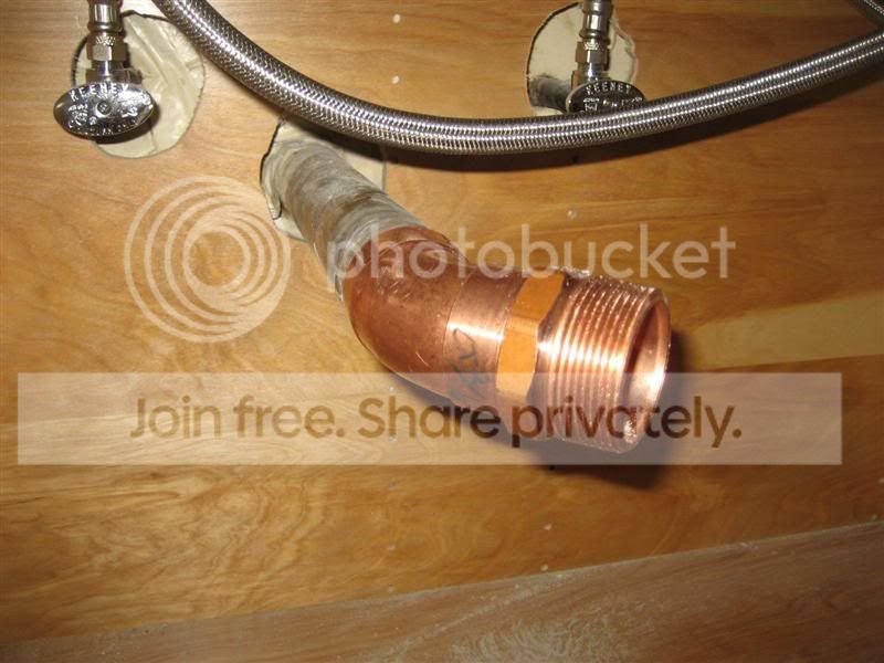

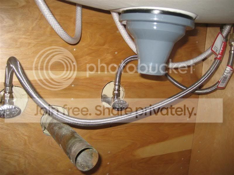

    Ok, i'm back. Was tied up doing other things but here's my plan. Hopefully I'm doing this correct.
    I'm going to cut the waste pipe closer to the wall to install a 45 degree angle street elbow and then put on the trap adapter fitting as pictured before. Then sweat the fittings on and connect the rest. The sink drain is not aligned behind the waste pipe. Sorry for the angled shot. Here's what I'm up to now..
    [​IMG]
    I just took a picture of this to see if the fittings fit...
    [​IMG]
  16. Redwood
    Redwood Master Plumber
    Joined:
    Dec 15, 2007
    Occupation:
    Service Plumber
    Location:
    Thats one cheapo junko looking basket strainer...
    Well how did the pipes line up?
  17. hj
    Joined:
    Aug 31, 2004
    Occupation:
    Location:
    drain
    That is NOT the drain adapter you want, because the trap tubing will probably not slide into it, and it is not designed to accept a slipnut and washer. The one you need WILL come with a nut and washer on it already.

    I will amend my earlier post and say that at this point a fernco would fit right in.

    I don't why you guys are telling him he needs an adapter. Go buy a 1 1/2" rough brass trap, you clean the inside of the pipe sticking out of the wall. Slide your trap arm inside and solder it up.

    Tech. Instructor
    Location:
    S. Maine
    Good call, but you ain't gonna pick that up at the cheepo depot.
