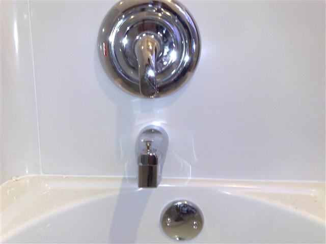

How's my plumber doing?
I'm getting dizzy looking at it.
If that's what other plumbing shops are doing, I should be raising my prices.
And the tub was there before he started installing the valve?
Was he texting on his cell phone the entire time?
Was it just too much trouble to "think" about what he was doing?

Hey Terry, thanks for responding. So looking inside the wall (bathroom 'B'), there's no reason to not be able to go to the right about 5 inches, is there? Is there some minimum distance between those males and the 90's? Because on the right, he's got like 3 inches until he hits the stud, but then he could easily shorten the distance coming out of those males (horizontally) to make up for the other 2 or 3 inches needed to align with the drain.
They took both tubs completely out to level them, because the first guy used spare pieces of sheet rock to shim the tub level. Yes, sheet rock - like that was going to hold it for long. So I don't understand why there are alignment issues. I don't even get why in bathroom 'A', the trim pieces are TOUCHING. If I were a plumber, I'd simply ask the customer - WHERE DO YOU PREFER THE TUB SPOUT AND WHERE DO YOU PREFER THE WATER VALVE TO BE (vertical height)? Do plumbers assume some distance? And are there any plumbers on this planet who actually leave no distance between trim when there's no good reason to even do that?
As a general rule, I'd advise center of tub spout at 17" from bottom of tub and center of valve 28" from bottom of tub. I'd also consider the size of the trim long before I even attempted to position the valve in the wall.

I'm surprised the guy got the overflow plate centered on the tub drain...:rolleyes:
Oh wait the holes were already put there by the tub manufacturer...
Was this another plumber hired by the contractor?

1. So looking inside the wall (bathroom 'B'), there's no reason to not be able to go to the right about 5 inches, is there? Is there some minimum distance between those males and the 90's? Because on the right, he's got like 3 inches until he hits the stud, but then he could easily shorten the distance coming out of those males (horizontally) to make up for the other 2 or 3 inches needed to align with the drain.
2. I don't even get why in bathroom 'A', the trim pieces are TOUCHING. If I were a plumber, I'd simply ask the customer - WHERE DO YOU PREFER THE TUB SPOUT AND WHERE DO YOU PREFER THE WATER VALVE TO BE (vertical height)? Do plumbers assume some distance?
3. And are there any plumbers on this planet who actually leave no distance between trim when there's no good reason to even do that?

WHEN were the holes drilled in the surround. If they were already there when the second plumber installed the valve, he HAD to put the valve where they were. If HE drilled the holes, then he really needs to check his ruler because there is NO reason to install the valves "off center" unless he is trying to align with some preexisting condition. And he might be a "hack" plumber just like the first one. He must have gotten lucky in the upper photo and just barely got the spout not to hit the faucet's trim plate. I also do NOT see anything securing the valves, unless it was added after the pictures. I moved from the North to the Southwest, and the union tried its best to send me back.

Is there some minimum distance between those horizontal males and the 90's in the bathroom 'B' picture? Is there some procedure to follow for cutting into the studs if more horizontal room is needed? Thanks.
The pipes going into the valve could have been street 90 els, or pipe that is ten feet long or more. It's under pressure and will find a way through.
And yes, you can drill studs if needed. And like hj mentioned, I don't see any backing supporting the valve.

A plumber sholdn't be ASSUMING anything, without input from the owners you put the valve in according to the DIRECTIONS that come with them!!

Got a hold of the plumber today. He said that he doesn't know what happened to the alignment. Said it must have shifted in the wall (even though he cut the holes in the insert OFF CENTER...which has nothing to do with shifting in the wall. Even if the valve in the wall had not shifted, it would have to shift to align with the off center holes in the insert, resulting in an OFF CENTER head/valve/tub spout.) Then he said he wanted to get paid for the one bathroom that I said would barely pass (the one with the trim touching..I said I could live with it, but I'm not happy about it.) Then he said that if I paid him half of the agreed upon amount, he may be able to persuade his partner and the third guy (helper) to come back out to finish the other bath (I guess they feel this is some sort of favor).
I told him about the manufacturer specs, and if he had followed them, he wouldn't have trim touching. He replied that he measured the fixtures at his house, and then at a friend's house, and he came up with the same measurement as what he did in the bathroom with the trim touching. I kept repeating READ THE DIRECTIONS, even bringing a direction book into the bathroom while he was working prior to the screw up. Back when I did that he said, "we're not done. Can you wait until we're done to comment? Just chill." Ok. I chilled. By the way, this plumber works full time for the County.
