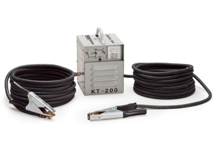

  18. Terry
    Joined:
    Aug 17, 2004
    Occupation:
    Location:
    Why all the talk about welding machines when Ridgid makes a pipe thawer already?
    http://www.ridgid.com/Tools/KT190-KT200-Pipe-Thawers
    For fast thawing of frozen metal pipes 1/2" through 1 1/2" (12-36mm). The KT-190 and KT-200 Pipe Thawing Units provide continuous heating to quickly thaw 1/2" to 1 1/2" frozen metal pipes. With these lightweight, versatile units, there is no need to dig or tear apart walls. Simply attach the clamps to the metal pipe on each side of the frozen section and the pipe is thawed within minutes.
  19. Thatguy
    Thatguy Homeowner
    Joined:
    Aug 27, 2008
    Occupation:
    A bounty hunter like in "Raising Arizona"
    Location:
    MD
    With 120 V and 15 A input it only takes something less than 1800 W, maybe 30 W per foot, to thaw enough of a gallon of ice in a pipe for water to flow again.
    Probably a welding machine does it 4x quicker but the problems with that method have already been discussed.

  20. Rich B
    Rich B DIY Senior Member
    Joined:
    Sep 13, 2008
    Location:
    New Jersey
    A welder would not normally "stick" an electrode and leave it that way. Even if he did, the electrode would overheat and burn up long before the machine or cables.......
    I am not a plumber....but I am a Lincoln and Miller certified welder repair tech........and I know more than a little about welders....been doing this work for close to 20 years now.....
    Those Pipe Thawing machines sell for around $800.......They don't list the full specs so I have to guess.......they are basically a high amp battery charger..... a fairly low DC voltage output and something low enough that someone operating it is not in danger of being shocked.......
    Welding machines normally have around 80 Open Circuit Volts and that can be AC or DC.......that is enough to give you a good little sting if you get across the two output studs......Once in awhile I get stung myslef and I work on them all the time......
    Now the High Frequency ouptut on many tig welders and plasma cutters is a whole 'nother deal altogether........3000-3600 volts at 1 million HZ......Not enough current to kill you but it really stings when your working on a steel bench and the HF gets on you as you go to start a weld.....

  21. Thatguy
    Thatguy Homeowner
    Joined:
    Aug 27, 2008
    Occupation:
    Location:
    MD
    Putting 30 of these
    http://www.allelectronics.com/make-a-store/item/TX-6310/6.3VCT-10A-POWER-TRANSFORMER/1.html
    in parallel is cheaper.
    Or, make your own
    http://www.google.com/imgres?imgurl...ndsp=28&ved=1t:429,r:24,s:28&biw=1488&bih=772
    I'd say the thaw machine has an AC output because rectifiers cost money and the pipe won't know the difference.
    I haven't run the numbers but I think that most of the power these things put out goes into heating the connecting cables and there's no way around this. The cable resistance is higher than the pipe resistance but you have to have long cables for long pipes.
    Since the pitch says "fast thawing" I asked Ridgid, How fast? Still waitin' on that answer.
