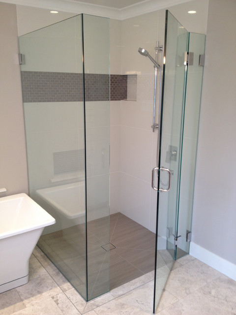

If you need shower niche design inspiration check out this Ideabook.
I love this niche I made with a side lit glass divider....

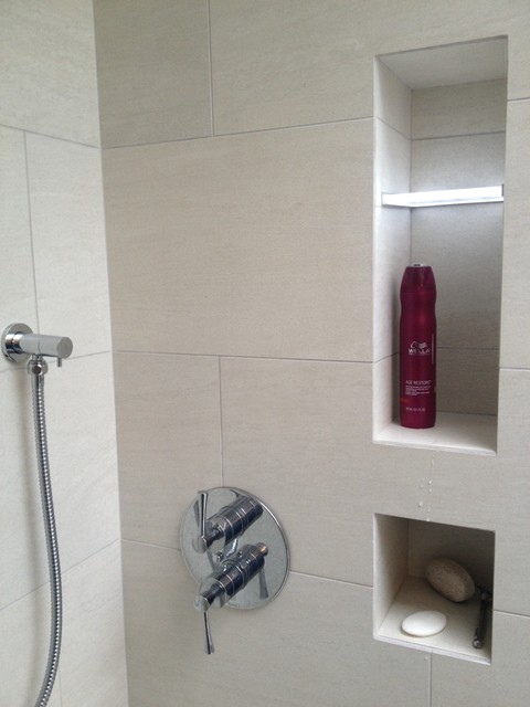

The niche below is the new favourite with my clients.

Framing Considerations for Custom Shower Niche Builds
Typically I center the niche and allow 1.5" of built up from the framing to the finished tile.

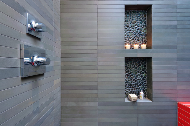

Hydro Ban Niches
The lower niche is a great place to shave your legs.
Mitered Tile Edges Make a Niche!
