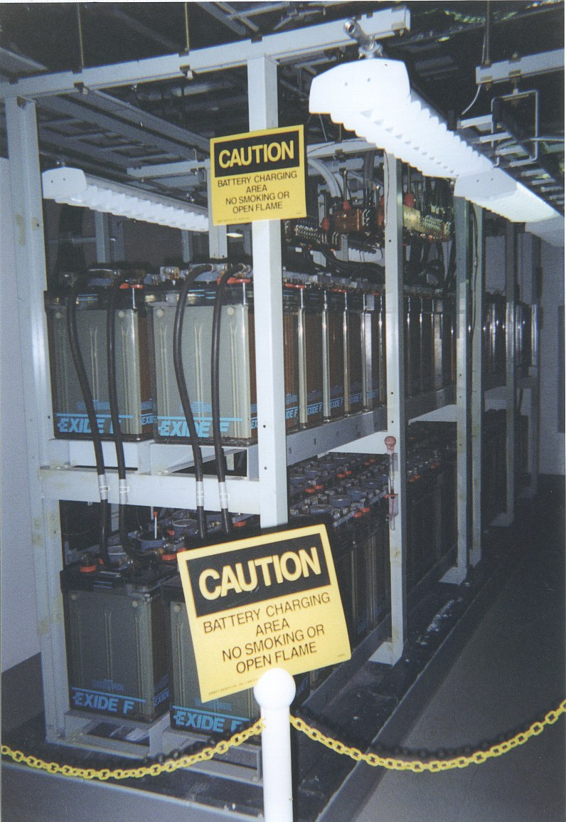

    Here's some batteries at the phone company...
    [​IMG]
  8. Thatguy
    Thatguy Homeowner
    Joined:
    Aug 27, 2008
    Occupation:
    A bounty hunter like in "Raising Arizona"
    Location:
    MD
    Can you imagine shorting this array? It would probably melt a crowbar. Violently.
  9. jar546
    jar546 In the Trades
    Joined:
    Feb 20, 2008
    Location:
    USA
    Great photo. I used to do all of the power cut ins for these battery banks in phone company co's. They only allow cut ins between 12a-6a to minimize the risk of losing phone service. There are backups of backups of backups inside most phone company co's. Many large city buildings have no windows for security purposes.

    I witnessed a dropped crescent wrench at one of these at a telco. It landed across 2 copper bus bars completing the circuit. It turned a spectacular color of white before melting.

    I am a little surprised at the photo, unless I can't see well. Are all those racks just bare steel? Light fixtures open to atmosphere??
    On submarines, we have a bank of 125 batteries. Each cell is about the size of 8 of those in the picture. The entire battery compartment is specially treated oak battens, and everything metal is coated with a heavy coating of plastisol. No metal goes into the compartment. You leave your watch, belt buckle, etc at the entrance hatch. All tools needed are specially coated and kept in the compartment. Light fixtures are of the explosion proof rated type. Hydrogen is nasty!
  13. jadnashua
    Joined:
    Sep 2, 2004
    Occupation:
    Location:
    Hydrogen in a sealed up submarine verses a building where you could vent to the outside are two different animals. Big problems if the ventilation fails, though, in either case.
