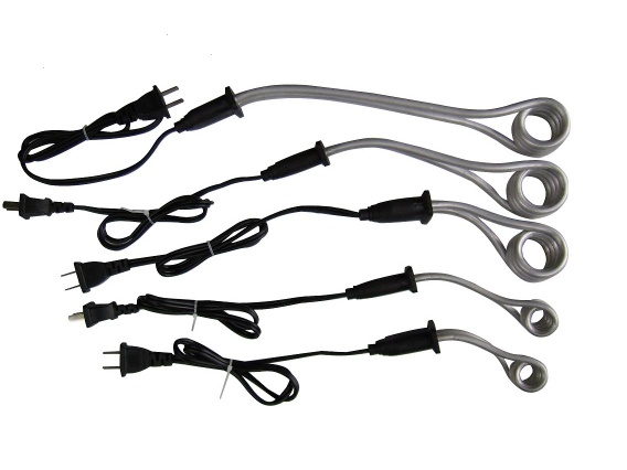

    If it is open, why not just hang an immersion heater?

    The reason for not using a submersion heater is i really need to heat the water from the bottom with circulating water so it is more efficient. If i have a submersion heater then i have to heat the top an push the water down to the bottom.
    I dont have anything against using a submersion heater since i was in the begging looking at using 4 300 watt fish tank heaters but it would take forever to heat up.
    One more reason i am trying not to use submersible heaters is b/c whatever heater element i use now i would like to be able to transfer it over to my stainless steel tank when ever i build it.
    I have even been thinking about running 4-6 4500 watt elements and making them all kick on with initial heat but only 1-2 run when just keeping the water warm. Since this tank will not be used everyday i would be able to heat the water within a very short time since the ambient air temp would hardly ever be below 50 even in the winter and it needs to only be heater to 90 degrees.
