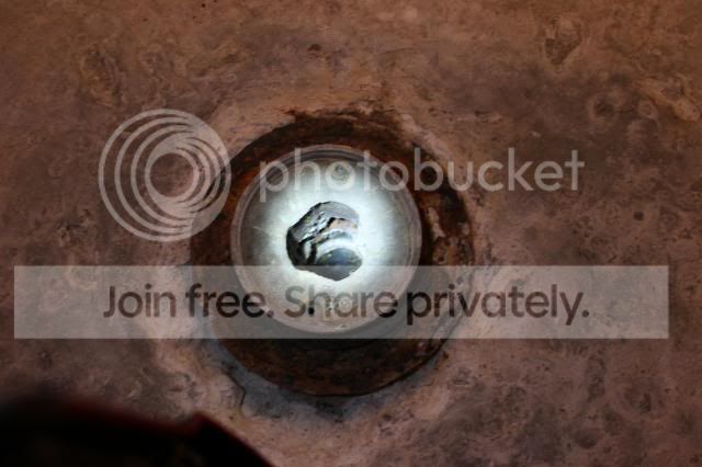

I'm going to try and tackle my plumbing for a basement remodel. I have two plumbing connections that I need to make, 1) replace the old shower with new for a Sterling shower enclosure. 2) Replace old bar with a new "wet" bar setup but do a proper connection not like what I found.
Here are some pics.
How for down do I need to go under my foundation to make the transition from cast to PVC? An even bigger question is what type of connector must be used, Fernco?
There isn't a vent for the wet bar, so could I use one of those sink vents that gets mounted up by the top of the counter? Sorry don't know the correct name.

Come one guys and girls I'm sure one of you can point out what the proper transition connector would be going from CI to PVC for these two applications. My plumber went AWOL so I'm left with doing this myself!
I'm sure its fernco type of fitting but more interested in how deep I need it in the ground?

Not sure what goes where in your photos, but when installed the bottom of the shower drain sits below the top of the concrete, and the trap must be positioned properly below the floor. The shower drain must be 2", and there must be a vent downstream of the trap to prevent it from siphoning.
Those pics are for two different areas. The vent for the shower is about maybe 4' away from the drain. The drain is up because I removed about 4~5" of shower bed under what I believe was a lead shower pan. I believe there is a trap way down below (there is about a 2' or better distance from the floor to the water) since I can see standing water and no sewer smell.
Is there a way to check to make sure there is a p-trap somehow buried below?

Unless there's a clog, standing water indicates a p-trap. Pour some water in, and if the level stays the same after a moment, it must have a p-trap and not be clogged. While the drains underneath the slab could be perfectly fine, they may also be on their last legs...it's a shame to install a new shower and shortly after find that there's a leak or the trap has collapsed because it rusted through.

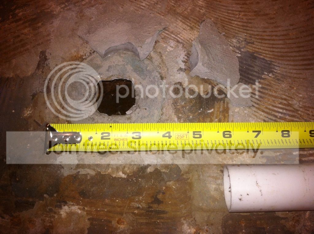

Is the drain on your Sterling enclosure really going to line up with your old drain? That sounds too lucky to me. If not, you are going to have to bust up the concrete and at that point you will be able to see what is going on down below.
I can't tell from your picture exactly what is going on with the connection of the lavatory drain at the floor. It looks like PVC tubular was shoved into a wiped lead joint. I think somebody faked it there. What you find when you remove the lead will determine the correct connection.
It will line up because the old shower was almost 60" wide and I am putting in a 48" wide unit (72220100). I already have the backwall and one side wall framed out for the enclosure.
That is the way I take it, that the previous owner just shoved the PVC pipe into the drain and cemented around it. I am hopefully going to get to work on the drains this weekend.

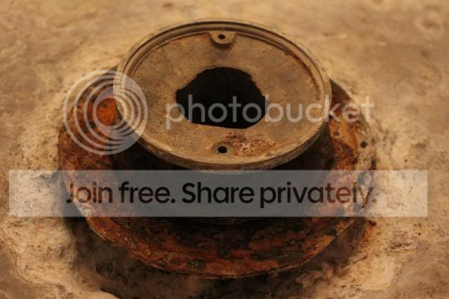

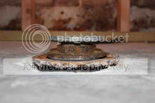

Ok, so I have some better photos of this shower drain that I hope will allow you guys to give me some better advice on how to procede. The height from the floor to the top of the drain is right at 2".
I was looking at the sink drain and it looks and feels like the square hole is some kind of metal. I tried a little bit to get it off but it was not budging and I didn't know if it possibly could be threaded on?

This is a guess...the top part of the shower drain may unscrew. Then, you'd have access to the clamping ring to take it off. Then, you'd have room to see what's left and deal with it. The squared off opening is probably distorted lead and if so, it is attached with solder. To get things off and see what you have to work with, you'll need to dig out some concrete.

What would be the best way to try to unscrew the drain flange? Use a pipe wrench on in with another holding the lower nut and try unscrewing it?
The same thing with the sink drain. If its soldered in am I going to just have to pry it out?

You'll have to wait for a pro to get a more detailed description of what to expect. When new, that upper part of the drain would just screw in/out to adjust the height to accommodate various heights of tile and the mud setting bed...after it's been in there for a long time, who's to say. The clamping ring normally has some screws or bolts holding it to the part that's actually attached to the drain (the liner would go between those two pieces). The bottom piece may be leaded to the CI. If something breaks while you try to unscrew it, it should be replaced anyway.

When I stopped by the Ferguson supply house they said that was probably the type of drain that I had by showing them the pictures. The shower kit I'm putting in has a 4" hole so I will need to put in a larger drain for sure.
