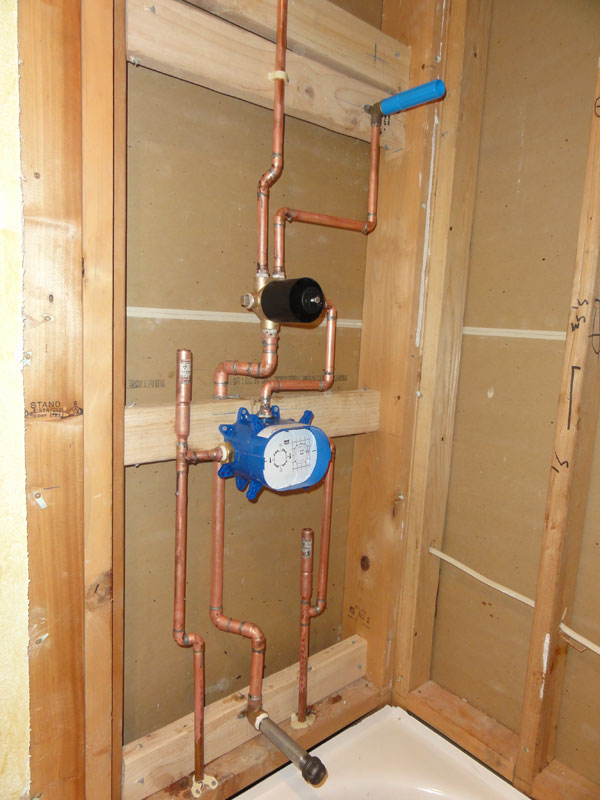

  5. Terry
    Joined:
    Aug 17, 2004
    Occupation:
    Location:
    [​IMG]
    With the 1/2" female inputs, you can either use copper male adapters, or PEX fittings.
    This rough can be configured many different ways. If your tub spout is 3/4", it's best to have a 3/4" drop ear and a pipe nipple there. I rough with a galvanized, and at trim I pull that and use a brass nipple. I carry an assortment to choose from.

    maryland
    Thanks Terry. From your picture it looks like you used 1/2 male adapters with tape and or pipe dope into the rough in box, is that correct? I would do that but fear that sweating a 90 right after that, with no straight copper between the adapter and 90, will damage the seal in the threads. Also it looks like your running a diverter valve for shower head, hand held, and tub spout. My layout will be more simple with just a shower head and tub spout with pull-up diverter, so I will use the top port for shower and bottom port for tub spout. Does that make sense to you?
    Thanks for the advice on the 3/4" drop ear and using galvanized and switching to brass at trim. Also I am just a DIYer so what are those copper fittings at the top of the hot and cold supply lines? Are the accumulators and are they code now?

    Location:
    They're hammer arresters. If your valve needs them, it will say in the instructions. You can add them. As far as I know, they are only required on things with fast acting solenoid valves, like the washing machine, dish washer, ice maker, etc. Maybe a question for your inspector, but probably not required.
