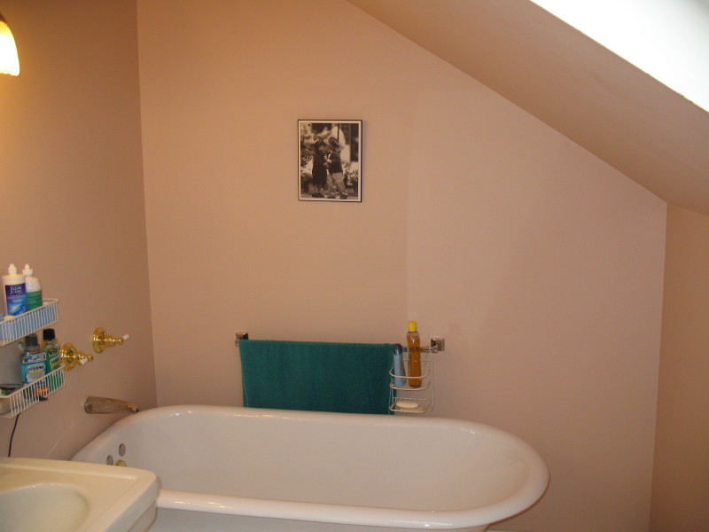

    We are about to rip apart our main bathroom (that has the only shower in the house) and therefore won't be able to use it during the reno.
    Our backup bathroom has a clawfoot tub (no shower) and an angled ceiling, but we *really* want to be able to shower there while the main bathroom is ripped apart.
    How would we retrofit some sort of handheld shower onto this clawfoot tub?
    This is what the backup bathroom looks like:
    [​IMG]

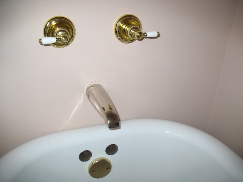

    and here is a close-up of the spout etc where we'd like to attach the handheld:
    [​IMG]
    Ideas??

  2. Verdeboy
    Verdeboy In the Trades
    Joined:
    Jun 12, 2006
    Unscrew your tub spout and replace it with one that has the extra fitting for a hand-held shower.

  4. jch
    jch Member
    Joined:
    Jan 3, 2006
    Location:
    Victoria, British Columbia, Canada
    Thanks -- I had no idea such a thing existed.
    Here I was thinking that I'd either need to find something to clamp over the spout's opening, or else have the hand shower threaded directly onto the copper stub coming out of the wall.
    I'll have to take another look around to see whether I can find one of these.
    Thanks again!
    .../j

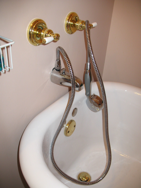

    Okay, thanks to your help I bought a new spout with diverter and the extra hand-held fitting.
    I also got a Delta hand-held shower unit, figuring that it would be well-built.
    When the shower is running, there are no leaks.
    The problem now is that, whenever I finish using the hand-shower and turn the taps off, the built-in vacuum breaker in the hand-held unit (a code requirement?) lets all the water drain back through its hose and out where the hose fitting screws onto the spout. It's as if this is a designed-in feature of the hose.
    Here's what it looks like:
    [​IMG]
    This hose connection point is *outside* of the bathtub and so therefore drains all over the floor and tries to go down where the drain pipe penetrates the floor.
    Help! What would you suggest?? Or does this not make sense...

  6. Basement_Lurker
    Basement_Lurker One who lurks
    Joined:
    Jun 21, 2007
    Occupation:
    I smash things and demand money.
    Location:
    Victoria, BC
    It sounds like the air gap is doing its job. Since your valve setup isn't exactly normal for a claw foot, your best bet is probably going to be to put some kind of extender hose or piece without an air gap into the tub spout and then attach the hand held shower to it, so that the air gap is always inside or just over the tub.

  7. Verdeboy
    Joined:
    Jun 12, 2006
    Or, just return your hand-held shower and get one without an "air-gap."
  8. jadnashua
    Joined:
    Sep 2, 2004
    Occupation:
    Location:
    It is working as it's supposed to, but unfortuneately, your filler is too far away.
    The vacuum breaker is there in case the hand-held spray is left in the tub of water and there is a hiccup in the pressure sucking water into the supply lines that is no longer pure., contaminating it.
  9. jch
    jch Member
    Joined:
    Jan 3, 2006
    Location:
    Well, I think I've got it fixed (for now).
    I bought a replacement (Delta) hose and, for some reason, the replacement does *not* have a vacuum breaker in it. So no more water pouring down the wall whenever the water is turned off :)
    I'm not sure why Delta would only put them on some of their hoses...

  10. GrumpyPlumber
    GrumpyPlumber Licensed Grump
    Joined:
    Jun 18, 2007
    Occupation:
    Plumber, self employed
    Location:
    Licensed Grump
    You need a vacuum breaker / anti siphon on the handle.
    Imagine someone washes the dog...leaves the handle in the tub.
    Then several fixtures in the house are opened at the same time as you try to use the handle....you can get a back surge of that dirty dog water in the water supply.
    Yuck.
    I'm sure you'd rather not be drinking dirty bath water....just a hunch.
    Some handles are made without protection because they are intended for use above flood level of the fixtures, example...a hand held shower that can't reach the tub.
