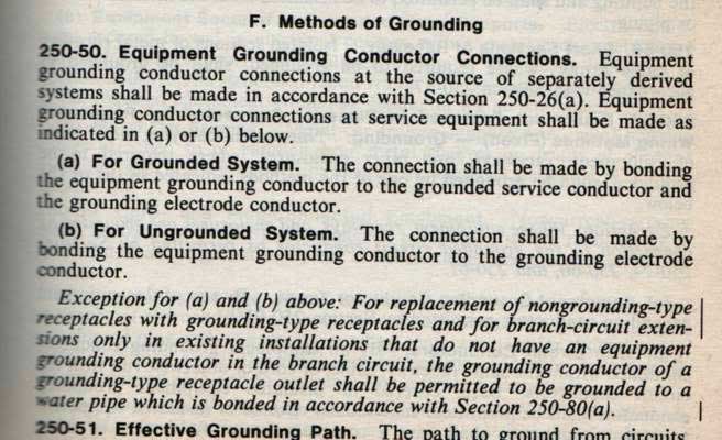

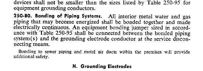

    This silly bonding of hot to cold comes from years gone by. In past code cycles the code mandated that all metal piping systems be made and kept electrically continuous. This rule included metal gas pipes.
    [​IMG]
    During this same code cycle period it was allowed to replace two wire receptacles with three wire receptacles and land the equipment grounding conductors on a metal water pipe.
    [​IMG]
    This has been removed from the NEC and has been removed for almost 50 years. The rule now found in 250.130(C) no longer allows the metal water pipe for the EGC.

    It became common place to allow the plumber to make repairs in metal piping systems using non-metallic repairs. To keep this metal pipe system electrically continuous would entail hiring an electrician every time a plumber was called. This was a undue expense on the homeowner would end up paying two different contractors when it was unnecessary simply because maintaining electrical continuity of a metal piping system is unnecessary.
