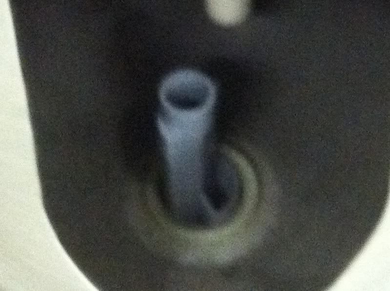

    BIRM does not change ferrous iron to ferric iron through oxidation. It is a catalyst. Period. Oxygen is the oxidant. BIRM works under certain water conditions and not under others.
    Call it a retention tank or a precipitation tank, doesn't really matter as long as it has a drain at the bottom to remove sediment or precipitants.
    Air injection systems using a precipitation tank uses the tank for two purposes; one--to oxidize iron (and other elements) into ferric state and two--to create dissolved oxygen levels of 15% or more in the water to be even and consistent in order to make the BIRM work effectively.
    If the water coming out of the top of the precipitation tank is already ferric (red water), then I recommend draining the precipitants more often. If ferric iron is chronic, then I would recommend adding Filter Ag to the top of the BIRM. I don't believe BIRM is intended to filter but to act as a catalyst in enhancing iron conversion.
    Water enters the tank through an elevated tube and exits through the top. The tank has a drain lower than the incoming tube. Neglecting to drain the precipitants causes the precipitated iron to accumulate and rise above the incoming tube, causing it to agitate and travel north out of the tank.
    [​IMG]
