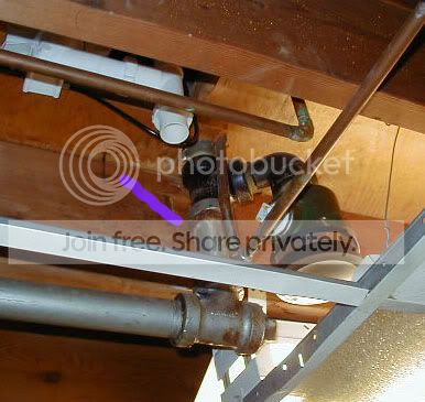

Ok, so we thought we were home free with the plumbing til we went to hook up the bath drain this am. This is what we found. This pipe at the end of the purple line is busted, with the treads busted off in the piece above it. The problem we face is the lack of room to spin and turn to get stuff off, so whats the easiet way to do this? Thanks for any help!!
kat-diy
23
ok update. Touched that pipe and it fell right off, leaving rusty threads stuck in both of the T pieces. Can't seem to bust that bottom tee off the lower pipe in addition to not being sure how to take care of the upper part.

Two large pipe wrenches should allow you the leverage to back the lower tee off enough to work on the broken pipe inside, and you can already get at the inside of the upper tee. You need to cut and pry the broken ends out of the tees. If you work carefully, you won't damage the tees' threads so much they won't seal with pipe dope. Now I have a question. What in the world is that bell shaped piece attached to the upper tee? Perhaps one of the pro plumber can ID it, but it's sure a strange looking thing to me.
Cass
5,947
You need to get in there with a sawsall and cut everything out that is galvanized leaving enough to attatch a banded coupling on to it and replace as much as you can with PVC. Go as far as you can go with the PVC.

sharp steel cutting sawzall blade
Thats a fun one
and Cass is !00% right
it looks like you could cut that pipe off above the floor
behind inside the acess panel
cut out that nasty old tee too.....
get yourself some fernco fittings and just rebuild
the whole thing with pvc and a trap
be sure to wear a hat cause you are gonna get
some FUNK spattering all over the place when you
cut out that Drum Trap
Also take out that GLASS panel or it will be covered in FUNK
lay some shets up there or yo u will probably
be spending more time cleaning up the mess
than the whole plumbing job took....

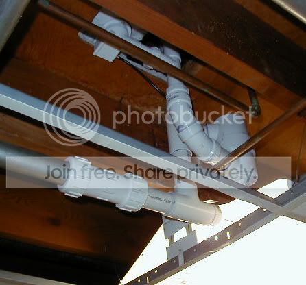

Thanks guys, just got back from HD with what we hope will fix this up. The threads inside those T's are completely shot, and we cant get the T busted off so we got a compression fitting for the bottom pipe, bought all new pvc tees and stuff and a new trap. Fortunately the pipe up through the floor is still behind an open wall so we are going to cut that and tap into that above the floor. I'm probably not explaining it right but it all makes sense when I see the pieces together.

We ended up tying into the vent pipe that you can see in my thread from the other day when we were trying to center the valve body. Thought we'd escaped that pipe but as it turns out we had to replace it anyway. If we'd known we would have gone ahead and made the adjustments to the valve. Oh well, at least we discovered this before the walls went up!

Here's the final results.

Well the drum trap appears upside down and the T with the C/O on it should be a Y and st.45 with a C/O. The right trap should be used. The coupling that connects the gav. to plastic may work but it is not a banded coupling like it should be. The banded couplings hold the pipe riged, that coupling will not. You also should have cut out as much of the galv. pipe as possible, there still seems to be quite a bit left but then again I can't tell how far the pipe continues.
Other than that it is a clean neat job.

Cass, shouldn't the plug on the trap be at the bottom? Are you saying it should be on the top? Yeah, can see what you mean about the Y, we just duplicated what was already there. As far as where we cut the galvanized pipe, it goes about 8 more inches to the left and we cut it there because there was some grooves from a pipe wrench further down the pipe that we thought might interfere with the fitting. The compression fitting seems pretty rigid to us, other than that is there any problems with this compression fitting?
