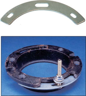

I pulled a toilet to install a new tile floor and the flange is sort of borderline. It has one of those red outer rings that apparently was never anchored into the cement floor, since it still spins freely. The inside part of the flange is fine, but this red ring is very corroded and the bolts will probably pull out eventually (if not this time).
Is the best way to repair this to cut out this outer ring and replace it with the same? If I do that, I'll have to cut the new ring in half to get it to fit under the lip of the inner part of the flange. Or should I leave it alone and try using a couple of those "spanner flange" repair kits?

Since you have a concrete subfloor, I would just leave the existing setup as is and just try to repair it, otherwise I'm pretty sure you'd have to bust up the concrete to install a new flange. I would just position the ring to the proper place and use some tapcons to anchor it; and if the existing screw holes were trashed, I'd just drill new ones in the flange. Then, since you are installing tile and raising the floor height anyways, I would use either an oatey flange repair kit, or just a flange extension spacer ring. Both of which solves your height problem and the toilet bolt problem.

go out and get two fernco spanner repair
flanges..... they should be able to slide
under the old metal flange rings you want to cut out.....
now here is what you got to do....
simply cut the ring on the toilet only where the
bolt has to slide into under the metal.....
put the bolt into the repair flange then
wrestle the bolt and repair flange under the old
metal where you made the small cut
and line it up in place ...
screw down a bolt to tighten up the whole thing..
it will last 40 years.

Would the Raven #BFR7900 repair flange work if you tear out the old corroded ring? If not, and this is still asking for trouble, then I didn't understand some of the recommendations:
I have the exact same problem, pretty much identical. What I don't understand is how to slide the spanner ring under the old corroded metal ring. Its snug against the floor. If you don't cut out the other ring, how can the spanner slide underneath it?

Try prying up the flange a bit and pounding the spanner in with a hammer.

That Raven Products #BFR7900 repair flange is the way to go in this siuation.
Oatey sells the same item #42777 Moss Bay Replacement Flange.
These 2 piece stainless steel flanges completely take the place of the rusted out flange on PVC and ABS flanges including clamping onto the pipe.

I ended up using that. I pryed up the old one a bit and slid the new stainless ring underneath. Pryed both up a bit to give my self some wiggle room and dropped the bolts through the new stainless one. Drilled out the old anchor bolt holes large enough to drop a couple of Tapcons through and secured it to the floor. Worked real good. Thanks for the help!

Yep I use them all the time.
You completely remove the old flange ring and its 2 pieces slip around the pipe and even lock into the groove on the flange that the old rusted ring rode in. just screw it down and you're good to go. You essentially turn an old rusted out pvc/abs flange into a new stainless steel ringed one.
I love em!
They go for about $10.
Have no fear cutting of the old ring!
These make it cake!
