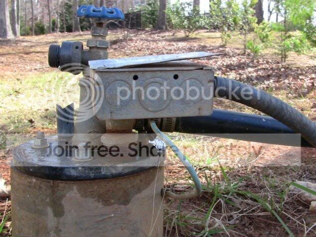

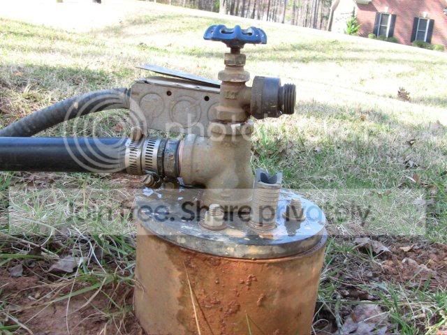

    Hi everyone,
    I need to do chlorination of my well, I read the instructions, and everything seems clear except a tiny thing - how do I actually open the well???
    [​IMG]
    [​IMG]
    As you can see One of the screws is right below the water pipe; also there was a plastic PVC seal on top of an air pipe (???) which fell off... Can I put bleach through that pipe?

    Do not remove the hose bib. You would be pouring chlorine into the well outlet pipe, which should be impossible due to the check valve.
    You are all set for chlorinating and recirculating. The recirc part is the most important.
    Add the correct amount of chlorine liquid through the broken off poly pipe fitting threaded hole, into which you will place a nipple riser and a hose thread adapter.
    Connect the hose bib outlet to a washing machine hose on one end and the other end on the new riser where you poured the chlorine. You could even add another hose bib on the new pipe riser as your closeable "inlet" port.
    Run water down the well for perhaps a half hour or more. shut it off.
    Now run water at all taps until you smell chlorine. Shut it down and let it sit 24 hours. Likely repeat. Flush it out good after each process.
    You dont need to fool with the cap, but you need to get that cap SEALED and covered.

    Ballvalve is right, there is no need to fool with the well seal. Work through the vent fitting.
    Unless you normally have a doghouse over the well, that electrical junction box should be replaced with one approved for wet use.

    Ballvalve said it best. Lastly, replace the broken off poly pipe fitting with a new vent pipe. The well needs to be vented.
