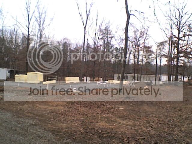

    It's a 3500 watt... thinking about cranking up the watts to give quicker recovery.... I wonder if it will handle a 5500 watt element. My switch box on the power pole outside is already overloaded. I'm trying not to invest any more time or money in this dump than absolutely necessary ... trying to get a house built here.
    [​IMG]
    my front yard.... this is why I am building where I am!
