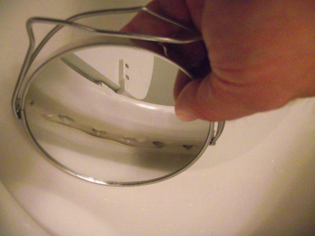

    The photo that Terry inserted above is of my Cadet 3. It was replaced 2 days ago with a Toto Eco Drake and now sits in the garage waiting to be disposed of.
    The following is a quote (used with permission) from a note from my partner to a friend of ours:
    "<achutch> and I went out to get a new toilet today. The one in the downstairs bathroom is only a couple of years old, but I started smelling an off smell down there almost from when I got here in February. I could really smell it when I was cleaning the bowl. I pointed it out to <achutch>, and he's been smelling it too. He thoroughly checked it out, and just below the rim is a large area that the glaze didn't cover the porcelain. He got the toilet at <one of the big box stores> (and it was the third one because the first two he brought home from there were defective.) The lady at the plumbing store today said that this was only one in a long line of horror stories she's heard about toilets from <the big box stores>. Apparently, the name brand companies have their toilets that are going to places like <the big box stores> made at different factories which are substandard to their regular products. That's how the "big box" hardware stores can sell them so cheaply!!"
    I will add that the lady in the plumbing show room, who is the self proclaimed Toilet Queen, told us that the Cadet 3 sold there is "a whole different animal" from those sold in the box stores. I even inspected the one on display and found it to be without any of the noticeable defects that mine had. However, once burned, one doesn't give second chances. Toto for me!
    On a side note, the lady told us that she has a friend who works in one of the box stores. Her friend told her that she should NEVER by appliances (or anything with a plug) from one of the big boxes.
    My washer & dryer came from one, almost 4 years ago...... I hope they don't decide to self destruct!
