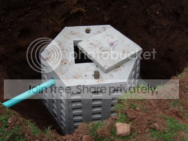

    A dry well is a possibility. It is a container or several containers together like the one shown below. Process stone is placed around this container to help the water absorption into the soil.
    [​IMG]
    \There are other configurations possible but this is the concept.

  21. RCraig
    RCraig Member
    Joined:
    Nov 20, 2004
    Location:
    New Hampshire
    drywell questions
    THanks so much for these ideas and advice. If I understand correctly, a dry well might be the best idea. Thanks so much for the picture so I can visualize this. I am still having a bit of difficulty understanding what would have to be done and how the dry well would work.
    I am guessing that I would dig a hole (?maybe a foot deep or so) next to my driveway.
    I would insert the white thing you kindly included to show me what a dry well is.
    One thing that is confusing me is that the white dry well in the picture has a hose attached to it. I am confused as to whether this hose is for water flowing into the dry well or water flowing out of the dry well. Sorry, my ignorance in this regard in legendary! Also in my mind is the question of where the other end of this hose would go to?
    I am guessing that process stone means some type of gravel-like stone. So I would put that into the hole around the dry well. Then I guess I would cover it up with dirt and replant grass on top.
    Another thing that is not clear to me is what the dry well actually does. I am thinking that it doesn't actually absorb water, but that is another question in my mind. If it is next to my driveway and doesn't somehow absorb water, I am fearing that it won't drain that well as it will be in an area that is also saturated by the rain. Also, New Hampshire clay soil, I am not sure that the water will percolate away that well.
    At the same time, leejosepho mentioned a 1000 gallon dry well. This might take a much larger hole than I was envisioning. Is the idea that the water accumulates in the dry well during the rainstorm, and then percolates away later on when things are drying out? A final worry is that I don't think that the drywell, at least as I am envisioning it, will get the water to the storm drain which is very close by. At the moment, the water only gets to the storm drain if I pump it over this very gentle mound, really only a couple inches of height to get over, then off it goes, problem solved until the next precipitation.
    Many thanks for all you help. Ruth
