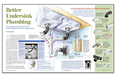

Take a look at the picture below and see if you see anything wrong with it... It should be good for a belly laugh! Sorry about the bad copy but I was not going to buy it to get you a better view.
Is that an AAV way down low? Hard to tell from the picture.
DW drain without an airgap, but at least there is a high loop.
Are those rubber fittings kosher? Also, there seems to be a lot more junctions in the revised job than there were in the original. I guess the rubber fittings allow you to remove the trap since I can't tell how that PVC is put together. The trap configuration now looks more like an S trap than a P trap. I see comments regarding the use of an S trap. What's wrong with S traps?
At least that is what these DIY homeowner eyes can see.

I actually read that article and used it under one of my kitchen sinks. The idea was to keep the piping towards the back away from damage and also to increase the drain size coming off the strainer by using a pvc fitting on the outside instead of a washer would collects dirt and closes the opening a little.
I'd like to hear all of your points on what is wrong with that setup.

No, that is a cleanout plug it is not vented properly. Or, even vented with an AAV for that matter.
The requirement for an airgap is not required everywhere but it should be noted that it might be.
Those rubber fittings should be outlawed! They are far from being Kosher!
S-traps are just plain illegal and not to code. They cannot be properly vented.

I think Rex Cauldwell is less like the moon landing and more like Roswell, New Mexico....
I would hook up the sink drain in the conventional manner with the pipes crossing over between the 2 sinks as high as possible to keep them up out of the way and avoid possible damage. I would also use slip joints to make it possible to disassembel for cleaning if needed.
His methods are definitely hacker handyman at best.
