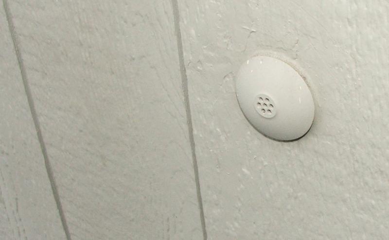

What does that look like outside of the house? - Just a PVC pipe sticking out of the wall, (mine is vinyl siding) or is there something more outside?

That little do-hicky is a "Johnson Tee" that serves as the air gap but it drains to the outside of your house and eliminates that extra hole in the countertop. It's basically a 3/4 x 1 1/2 x 1/2 tee. The portion that sticks outside of your house is a 3/4" piece of plastic pipe that would have cap on the end with holes drilled into it. As far as I know there are only a few states that require an airgap on a dishwasher, Washington and California. I believe, but I may be wrong, that most states allow you to do a high loop under the cabinet and connect to the disposer. I'd find out if your state/city requires and air gap first then go from there.

Yep - I was able to find that name on the interwebs. I haven't found anyplace that sells it online. I'll take a drive over to my local supply house and see if they carry it. Does anyone know where to buy one online?
This is what the outside looks like:

you can make one with a 3/4" tee. A cap is a screen to prevent bugs from entering. You cap it yourself.
