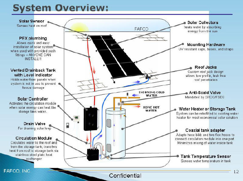

Are you just in need for a water heater or to maintain your water warm or are you planning to keep your whole house warm? Those person who offered installation how much is their price range? and do they offer any assurance after the installation if something will go wrong?
I saw this photo in the net this is how sungrabber looks like :
