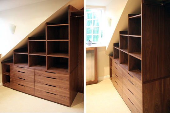

    My little girls are growing up and the small closets they have are quickly getting to small. Is there any ideas here on maximizing the storage space in closets?
    How many people are in the same boat?
    I'd like to get more storage and finish the inside of the closets kind of like this
    [​IMG]
    *Picture Source
    I think I read somewhere and old Chinese proverb that said the more you subdivide a space the more room you get. Something like that.
    Would love to see some examples!
    JW

    quote; old Chinese proverb that said the more you subdivide a space the more room you get.
    If you subdivide it enough, you will have a closet full or wood shelves and dividers and VERY SMALL, (if any), OPENINGS to put stuff into. How big are the closets?

    HJ the closets are all pretty small. About 28" deep x 48" wide x 96" tall. All three with a sloped ceiling from 96" down to 72".
    I like the idea of putting the drawers into the closet so they have more space for their socks and tiny clothes.
    I have never seen the pull down drawer before (fifth picture in Ideabook called Chicago Closet Design) - the Lady that designed these closets works out in Chicago and I'm wondering if anyone in Vancouver sells similar product.

    I'll have to measure up the spaces and see what fits. I like the idea of having the pull down drawer for the kids closets. Maybe once installed we will be able to see what colour the carpet is in my eldest daughter's room!
    I'm debating the use of a double rod system or a small storage unit with drawers.
    Closet design is not one of our specialties but since the girls closets are so small I really want to max out the storage. JW

    I've done double rods but this was more setup where a grown adult can reach the clothes on the top rod, and this is where more unused clothes were hung. The top rod was literally 3 AFF the top of the ceiling..
    You don't won't to go too low on the the bottom rod, cause it will not be high enough to hang her dresses and such ....in due time.
    I like cubed/drawers for organization purpose...but every shelf, every pull out, just takes up the real estate where a extra shirt/sweater might stack up.
    Had this made awhile ago. Hope this helps...

    Love the drawers Chef! Is that just a cutout for a drawer pull?
    Do those shelfs adjust? A few must be fixed I'm thinking for support. JW

    It's all fixedshelving. Just a cutout on the pull, but I have done several variations of the *slab handlness look* as I just prefer thing handleless....
    I've used some magnetic throw catches they use on *airplanes* for solid slab doors, so doors are complete invisible....
