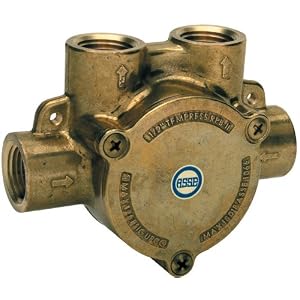

Jim, do you have any knowledge if something like this would help?
This would likely compound the problem you have...as stated, there are two different technologies that can meet the antiscald federal requirements: pressure balanced and thermostatically controlled. While I can't say this with certainty, my gut feeling is that a thermostatically controlled valve would work better at maintaining temp than a pressure balanced one. A pressure balance valve assumes that the hot and cold supply temperatures are constant, and tries to maintain the selected balance. A thermostatically controlled valve adjusts the hot/cold flow rates to try to maintain a constant temperature...two different ends to the same means - keep you from scalding yourself. The valve you linked is an in-line pressure balance device, similar to what is in your Delta valve. Depending on the series, you may be able to utilize a different cartridge in the Delta and get a thermostatically controlled valve. On some rough-in valves, you can use three different cartridges, I think you have a pressure-balanced version with separate temperature control and volume controls. I put a similar one into my mother's house as she lives alone on a conventional water heater, and a thermostatically controlled valve wasn't a big advantage and she didn't want to spend extra for it. I think in your case, this may be a worthwhile upgrade.

You already have a "pressure equalization" device in the shower valve. All a second one would do is restrict the volume AND pressure to the valve. We cannot tell if the temperature fluctuations are due to pressure imbalances, although it is not likely, or that the temperature TO THE VALVE is changing, and we cannot give an answer without being there and doing our own testing. ANY of the conditions you asked about could be causing the problem. Your options # 5, and 6 would NOT be solutions.

Your valve already has a pressure balanced valve internal to it. Adding a second one is not likely to help. If the actual supply temperature is varying radically, something is wrong, and the valve won't fix it. As said before...a pressure balanced system does NOT CARE about the actual temperature, it is trying to keep the flow constant during use. If your hot temperature water increases, it has no way of knowing that...only if the flow (pressure) changes does it try to adjust and keep the hot supply/cold supply ratio the same. It WILL NOT keep the temp constant if the supply temps are changing. A thermostatically controlled valve has a chance, it depends on how rapidly it does change. The two types of valve are fundamentally different: PB, constant flow ratio; thermostatic, constant temp output. They both can achieve a similar safety feature, but comfort wise, the thermostatic valve wins since, say on the tank, as the hot water gets used up in a tank, it can cut back on the cold. A PB valve would just let the output get colder, only keeping the relative flows the same between the hot and cold supply.
