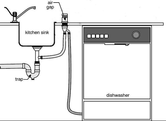

Shacko
Master Plumber-Gas Fitter
559
Rosedale, Md
If you want to keep your dishwasher without the disposal this is how it should be hooked up
Gary Swart
8,101
84
Yakima, WA
That's a great diagram! It really shows the fitting I described earlier to DW connection, and it's a good illustration of the rest of the drain connection. Thanks.
