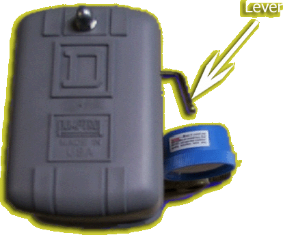

    No, I mean about 10 PSI below that. I assume from what you wrote, that you have a Square-D switch with a lever on the side that you have to hold "just so" to reset it when it trips (low cut-off).

    The low pressjure cutoff is a cutoff that detects the pressure has fallen too far below the normal pump-turnon pressure. This could indicate that the water level has fallen, the pump failed, or some other thing has failed. A concern would be that some minor fluctuation might cause the condition to be detected too sensitively.

    thats exactly what I have.
    I have that set around 40ish now
    pressure tank at 38

    OK, glad that is confirmed. Have you determined what PSI the low cut-off actually trips?
    The actual trip point is not adjustable and generally follows 10 to 20 PSI below the cut-in setting. In my case it would invariably trip when I was not home and I would have to talk my wife through resetting it over the phone.
    A happy wife is a happy life, hence my switching to the EPS15/99.
    I have never had a legitimate reason for it to trip so as far as protection goes, it has never provided any protection, only nuisance.
