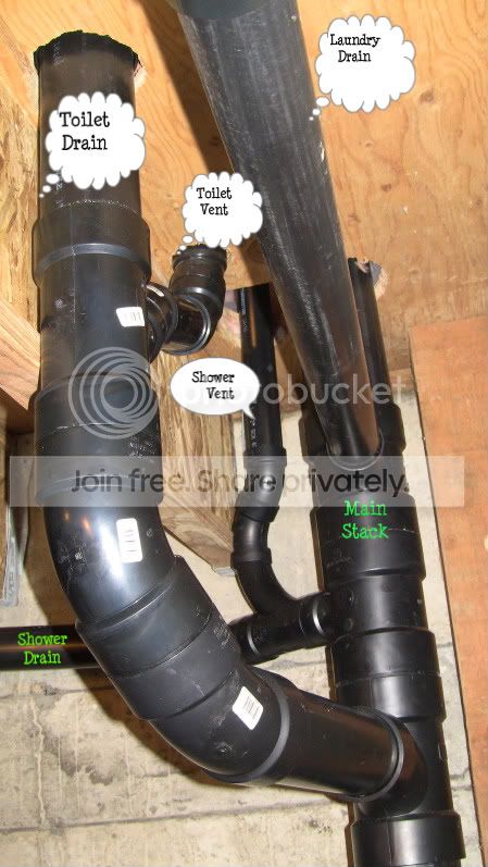

Okay...so I posted a few days ago asking about venting a toilet with a small almost horizontal run before going vertical....Here is what we are left with....what needs to be fixed, what doesn't work...etc. Thanks guys for your honest advice!

I might have gone with a straight run off the shower drain with a T to do the vent...
But one works with what one has, and that is never more true than in Alaska as 95% the store is not just up the block.

We can not run a horizontal vent under the floor here. That being the case, in your situation, I would remove the 2- 3" 45 bends and install a 3"x2" combo (tee like you have for the shower). The 2" will run vertically up through the hole for the vent and then use a 3" long sweep 90 and run up to the closet flange.

Akpsdvan...that is the way we had it originally with a T as the vent, but I was gathering from folks here that I needed a combo for that vent. I did talk to the permit folks here today, and the plumbing inspector agreed. We are out of the city jurisdiction, but we still have to have a private inspector check off our work....
dcelite...Do you mean at the horizontal area of the toilet drain, have a combo with the 2" vent...? We thought we might do that in the beginning, but weren't sure if the toilet drain could drop that far before the vent.
